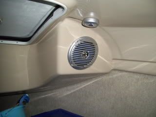

Here's some pic's of my 2004 M stereo install in 2009, it's a Jensen Marine Stereo
I added 2 front speakers to the V berth area a year later in 2010.
Hope that this helps.
Frank L.
Posts: 6698
Re: Marine Stereo Installation
Frank,
Your set up is very similar to mine, with exception of where you located the aft speakers. The location of where you and I placed the receiver will not work on an X. X's have a different location of the head, thus completely open stem to stern.
