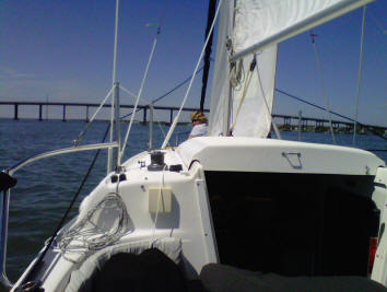

Just finished testing and posting my newest mod... a Stay Sail... (aka Cutter Rig)
Features:
====> Self Tacking
-using the smallest track and car harken makes. Video: [url]mms://208.180.16.65/StaySailTacking.wmv[/url]
====> Roller Furling
- didn't know they can make roller furlers that small.
====> Detachable
- I can lift it off the deck and lay it up against the mast while on the water if I don't want to use it.
====> Good Reading Spot
- my wife can read a book on the bow. (didn't really plan that one... just kinda happened.)
Cons:
-----> I blame Billy and Ron for putting the idea in my head. 8)
-----> Can't open the front hatch when it is hooked up. (unless I detach it) :|
-----> It added 1 minute to my 9 minute set-up and launch time. :P

Parts:
West Marine:
Furler..........................149026..... ($218)
Turnbuckle....................171613
Long D Shackle...............110751
2 snap shackles...............148702
2 blocks........................200027
1 jib lead.......................10947604
1 cam cleat....................367211
2 stanchion furling leads....2637312
Lowes:
100 feet of Jib sheet $90
from Harken directly: ($220)
2707.1.2M track micro
274 Track Bend
-------6.5" radius
-------5" chord depth
-------3'10" length
-------horizontal bend
---------------------( i had to bend it vertically just a little, make sure to heat it up and bend it slowly and evenly.)
2700 micro car traveller
2706 2 track end stops
Online:
Used Jib Sail ($200)
Local Sail Shop:
cut and add sunbrella
Total: $1048
There was probably some more small things... but I didn't keep exact track of everything. (didn't get everything at once, easier to swallow in small trips)

That’s ok imitation around here is the best form of flattery provided you are man enough to handle the BS that goes with it. However there will be less BS when you take someone else’s idea and improve upon it. Eric has definitely improved upon the staysail idea with one exception. I think Eric’s staysail moves out to far. This extended travel will not allow his boat to take full advantage of a staysail that can allow you to get so close to the wind that you can sail on a beat.
