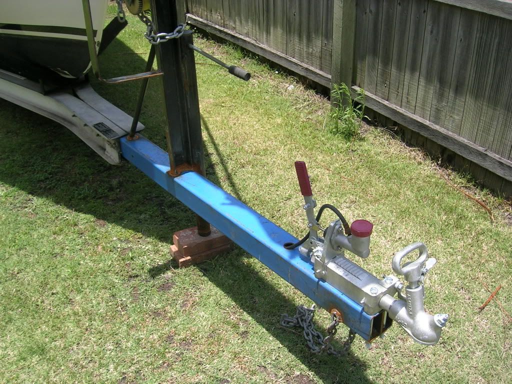

they are supplied 2 inch. I got my trailer still with the US tow hitch on and it was used on my and the POs 50mm balls for the first 4 years with no issues. I recently put a 50mm hitch on the trailer mainly because a) its illegal to have the imperial hitch and b) US tow hitches do not have hand breaks.
The new blue bit is because the original had rusted through. I have now rust treated the inside of this and painted it black like the original.
