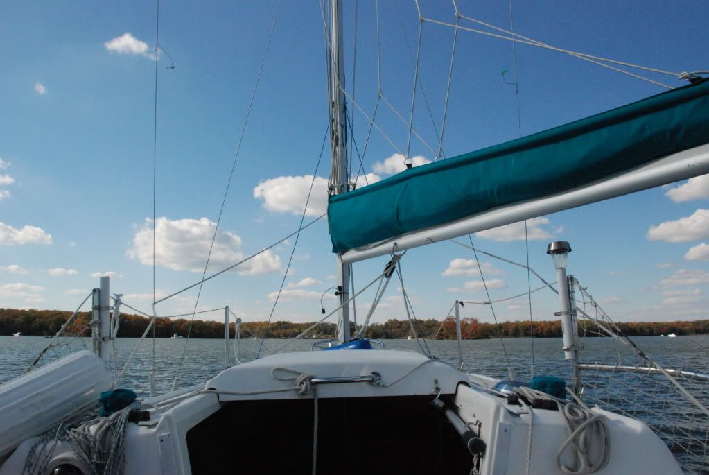

The reason why I am looking at this is because we are working on a stack pack and the diffrence in height is very significant, about 10 inches higher if we do not solve the mast gate gap. For those of you wih a Doyle stack pack or the sailrite kit, how high is the pack at the mast?
By my calculations is going to be about 24 inches versus 14 if doing something like what restless or Summer did. Would the high differential affect performance?
I currently have lazy jacks that will be adapted for the pack.

BTW, I bought Tom’s external mast gate and it works great. It allowed me to build a much lower Sail Pack and gives the boat a sleeker look. No need to undo, store and reattach the mainsail cover and deal with lazyjacks. All I have to do now is unzip and zip the top of the pack.
