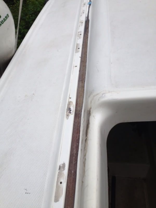

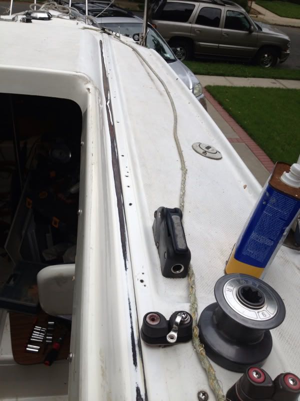

- Gazmn
- Posts: 1129
Re: Main hatch sliding
This is the damage lying underneath from years of scraping by
Gonna Marine Tex it & Velcro the hatch part since I did all the dirty work taking off the hardware
[Thanks Dive]
I'll raise the rail guide, perhaps with butyl tape.
Thoughts anyone?
Thoughts anyone?
Gazmn, while you are at it you might check that the rail holes into the gel coat are countersunk just a bit. Will stop the gel coat cracking. Somewhere I read this. I have some hair line cracks spidering out from one of the holes.
I fixed the sliding on mine btw. A bit embarrassing really. Took the hatch out again. Really cleaned the top surface with acetone including the residual glue from where I folded the velco over the edges to the top surface on both ends - found it too thick to slide - removed the velco and clean forgot about the dratted glue left behind
- re-assembled and used liberal amounts of silicon spray. Smooth as now. So I think that being able to fold the velco over the front and back edges may be nice - check for clearance before trying this. All up a worthwhile mod. Luckily I got to it before any real gel coat damage like shown by Gazmn but then I have a 2011 hull so quite young.
