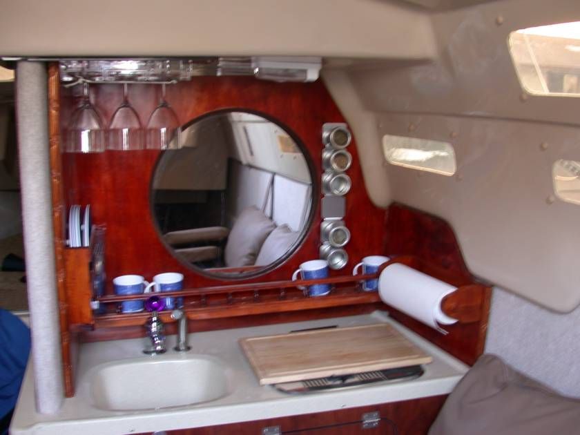

mirrorplex
Here's what I'm doing with mine. Don't be fooled. The craftsmanship is fairly mediocre in places, but it serves my needs for the time being. i didn't screw into the plexi-mirror, or anything else. the 3/4" plywood pieces are jammed in and screwed together, sort of pressure fitted to the available space. i spray painted the back of the plywood with flat black so it wouldn't reflect the back of the raw wood.[/img]

Re: mirrorplex
Looks good. Close to the idea I was going for. Reduce the size of the mirror to build some built-in accessories (paper towel holder/rack, etc)Richard O'Brien wrote: Here's what I'm doing with mine. Don't be fooled. The craftsmanship is fairly mediocre in places, but it serves my needs for the time being. i didn't screw into the plexi-mirror, or anything else. the 3/4" plywood pieces are jammed in and screwed together, sort of pressure fitted to the available space. i spray painted the back of the plywood with flat black so it wouldn't reflect the back of the raw wood.[/img]
Question, how did you attach the wood panel to the daggerboard trunk?
The rack you mounted to that board on the db trunk looks similar to what we bought.
How did you remove the old mirror? How did you hang the new one?
I am trying not to reinvent the wheel
Wow!!
Richard, that is awesome!!
I'm guessing you left the entire old mirror intact and the mirror we see is just a hole in the plywood? I think you're going to see a lot of copycats among us 2003-2004 26M owners!
My question: Can we buy the same sort of laminate that MacGregor used on the original cabinets so that everything matches? If so, where? If not, what finish have you folks found that most closely matches the original cabinetry?
Your idea of using the angles and channels already built in the satructure to hold everything in place matches the concept I've had in my head for a while, but until now I lacked the vision to make it work!
Great, now that I have several canvas projects lined up, I have a new woodworking project to add to the stack...

this might help
Thanks for the kind words guys. Yes the mirror is the same one, but you wouldnt want a glass mirror on a boat. The three main components are: 1. the back panel, ogee routered edge of hardwood plywood. 2. The starboard panel which was made twice but fits tightly into the available coffered area, and holds the back panel tight to the mirror on that side.3. The port daggerboard trunk panel which I scored to run inside the left edge of the back panel. It is fastened with 2-1/2screws and a long magnetic bit thru the slot between the forward side of the trunk, and the mirror. The port side panel with the dish rack is held at the top by an acrylic wine glass holder from RV Camping world. This is getting replaced by wood since the goblets slide out too easily. Nothing is screwed into the boat except the wine glass rack. Everything comes apart. The towel holder is oak stripped of its finish and dyed with aniline dye, The only kind strong enough to match the mahogany laminate. The gallery spindles are from Lowes. Nothing is square, and I had to do everything twice. I hope this helps.

nice job
'Just looked at your mod Craig. Wow! very nautical , Simple (I know it's not really) & Clean looking. Do you have any trouble with things bouncing around on the rack? I can't completely figure out what holds the objects down?
