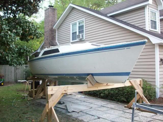

81venture
- Posts: 553
- Location: Wake Forest, NC
Re: MacGregor 25
1. Build this (or have a carpenter friend help)
2. Pull out the trailer
3. do keel/bottom work at leisure
4. Don't be lazy, fix up/paint trailer while boat is off
5. Replace boat on trailer
6. Beer
