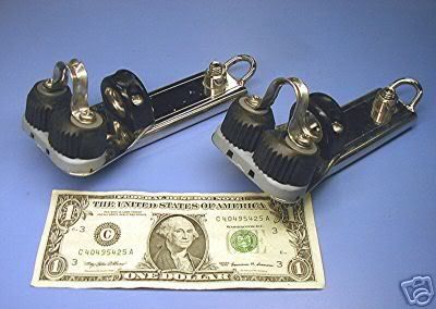

I went out last night single-handing to try out my new EZcleats.
http://www.macgregorsailors.com/forum/v ... f=8&t=7257
(They work fantastic BTW, I don't even have to leave the helm bench and I have full control over all my sheets.)
