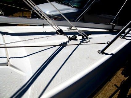

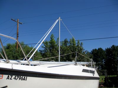

We were away for awhile, but now once again, I am able to work on the boat. Indeed, a couple of friends came by early this morning just to help out. If I keep using friends like this, I'll soon not have any friends left. It was hot, Arizona hot. Yes, we worked early in the morning, but even that did not seem to help. At least, though, we got a start on the mast-raising system. We're almost there, but some things are not quite right yet; maybe some of the salts and ne-er-do-wells on this site can take a look, laugh, and offer some hardy advice.
We were able to get the mast down by using our new block and tackle. Everything worked fine; there were no casualties, no one abandoned crew and ship. We did abandon the becket, though and secured the line to a cleat on the foredeck. To be able to use the becket on the block, we would need a swivel as well. Otherwise, the lines will not stay parallel.
Does this set-up look right? Is there any advantage in using the becket over using the cleat? Here is another photo, just to show that we did not exaggerate when we said the mast is now down. I secured the gin pole to the mast by using the jib halyard. I suppose this is how the system works. No need to worry about the power lines in the distant background. We're a long way from Tipperary.
The problem were are having at the moment are the baby stays. At first, we attached the stays to the gin pole, and that kept the gin pole from swaying, but the mast began to follow Fleetwood Mac, and go its own way. http://www.youtube.com/watch?v=6ul-cZyuYq4
We next attached the baby stays to the mast instead, but even that did not keep the mast from swaying. Are we suppose to use the cleats on the mast to secure the two baby stays, or must we add an eye to the mast?
Oops, looks as if I may have found my answer. It's amazing how clear something can get once you read the directions and give it a try. Yes, of course, I had read this, but once on the boat, and under the Arizona sun, you forget what you may have read. Having made and used the block and tackle, everything makes much more sense now. Looks like I need to get some S hooks. All of this reminds me of another song by none other than Dr. Hook: "When you're in love with a beautiful woman . . ." Well, shiver me timbers here's young Jim Hawkins!

Jim, the baby stays should attach to the deck and make an A-frame of sorts with the mast in between. Depending on how tightly you adjust them, they will still allow a little side-to-side movement of the mast as you raise it, but not enough to go anywhere. That slack will (should) go away as the mast gets more vertical and the shrouds start to get tight.

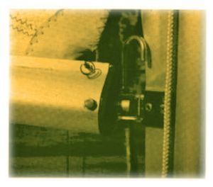

Boom / Mast Setup
My boat uses a bolt from the hardware store.
What should be the connector?
Has anyone used a clevis pin?
Steve, a fellow Mac 26 S sailor, just wrote to me a moment ago and described the connector as a "J" bolt. The curve in the "J" bolt apparently allowed a place for the main to reef. That makes sense to me, so I searched the manuals again, and discovered what seemed to be a photo of the original set up. After enhancing the photo, maybe the image will be a bit clearer for all of us. I hope so. Perhaps, the image will help someone else who may have been just as confused as was I.

Boom / Mast Setup
