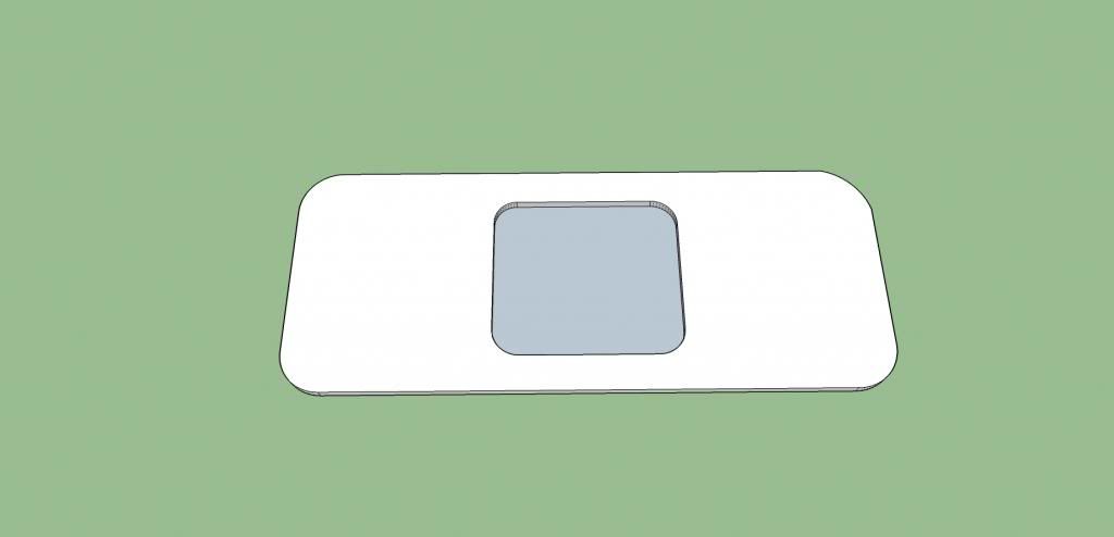

Crikey - there are things you can do to make the wrap plates easier to bend where you want it to, if you are thinking of DIY'ing it. Like making it with a cut-out in the area where the bend will be. Drill 4 holes and cut out in between them. The thinner areas will give you some flexibility in playing with the bends to get what you need size-wise, and still give you some rigidity in the end. You can also grind a series of evenly-spaced grooves (just with a hand-held angle grinder), say halfway through the thickness of the material, to make the bends follow a radius (though stepped a bit).
