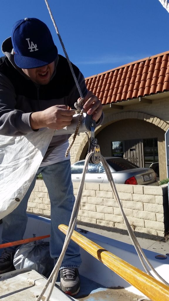

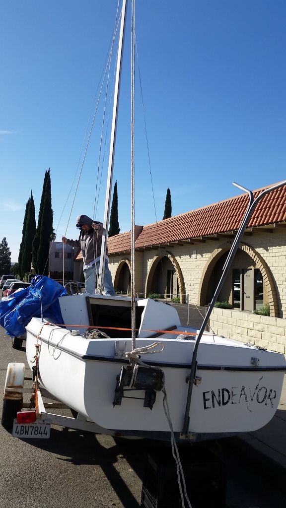

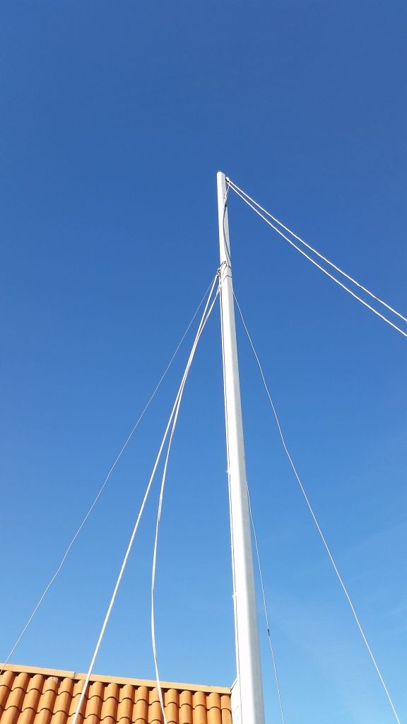

I think my rigging is all there.. backstay I used rope bit didn't need it... you guys think it's safe? It feels right

Miguel
From what I can make out from your photos:
You have a Venture 21 with the most basic of rigs.
Fractional sloop, 1 fore-stay and only 2 shrouds. No back-stay required.
The only thing on your boat that holds the boom up is the mainsail when hoisted
(you can rig a topping lift to hold it up if you wish).
The chicken head that you posted probably was never on your boat.
It looks like you are getting it together! Nice!
