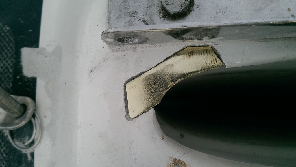

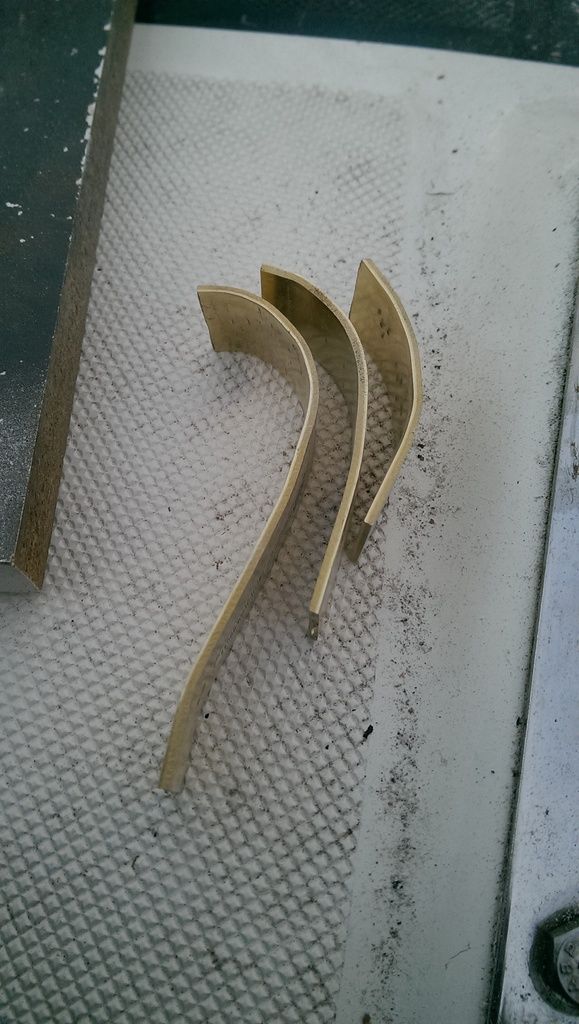

Started the repair attempt to give the mast foot something structural to support it. Started by grinding away bad fiberglass, trimming excess sealant, and prepping the surrounding area. Then, cut and bent 3 brass strips to act as fillers Image

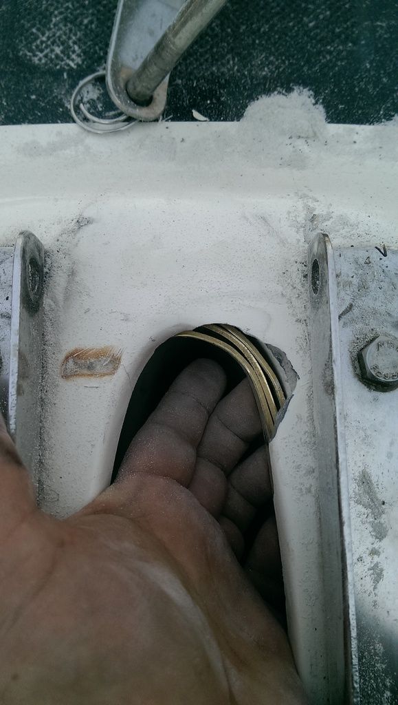

Here they are where they will end up. Image
And one more for a top bearing area Image
If I do this again, I will use epoxy putty, not anything that can sag on a vertical surface - I probably held these in place for over an hour. Hopefully I did not develop any bad voids.
Now I need to clean up and fair out - and finish up with some gelcoat.
If this does not work, will likely install the doubler plate between the deck brackets and the deck.

Looks good. Once you got grinding into it, was there any sign of voids or weakness underneath explaining why it failed? It looks like making a dam and filling it with resin, with a meniscus proud of the deck surface and then grinding/ sanding it back flush, as others have done, is also a viable fix.
Have you laminated brass with resin before? How does that hold up to corrosion? I might try that sometime, somewhere, in the future.

Damage was limited to the deck flange overhang into the daggerboard trunk. The contact area was situated perfectly to wreck the unsupported 1/4 inch thick fiberglass - it never had a chance.
An integral mold would have been much easier - but sometimes I just end up doing things the hard way. Since this is a point bearing situation, I wanted some serious metal involved backing the load versus filled resin - and used the metal to spread out the load path. I wanted to use stainless steel but my locally available choices were carbon steel, aluminium, and brass. Carbon steel no way, brass stronger than aluminium. Can always adjust later.
