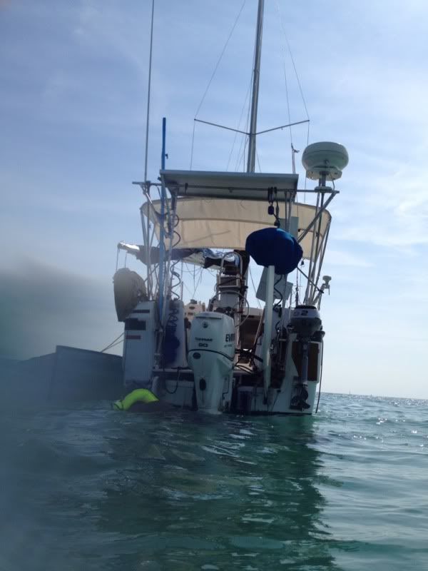

Re: Second Motor(Kicker) on 26M
Post by mdeane »
mdeane wrote:
NiceAft wrote:Russ,
Does that interfere at all with a hard starboard turn :?:
The space is tight, however, when hard starboard there is no interference.
Marc 8) :macm:
http://imgur.com/schLWjL
Photo added
