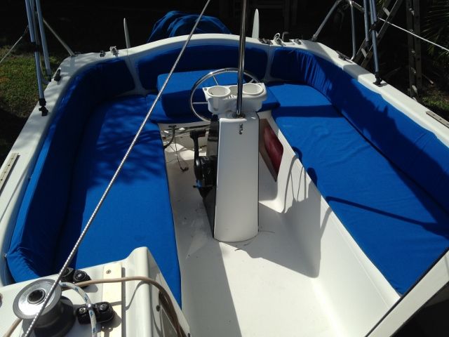

I used 1 inch close cell foam with sunbrella covers and Velcro fastners.
Easy to store below deck as is 3 times less thick than stock and water proof.
Notice the Helm seat, click to enlarge photo. This is 4 inch reg. foam with 1 inch close cell foam on top, gets the person on the wheel higher .
Best comfort seat on the boat.
Interior cusions are the same,high desity 3 inch foam with 1 inch close cell foam for those who go below with wet cloths.
