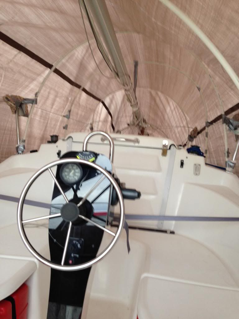

For the past 7 years I have used this system of PVC pipe and 20x30 tarp. The tarp lasts a few years, maybe longer if I pad sharp points with carpet to prevent it from poking or rubbing through.
I wrap the stanchions with a paper towel and used duct tape to secure the poles. Duct tape is great for attaching the poles. Simple 1/2" x 10' PVC for $1 each. Then I get a roll of cord and lace the tarp under the trailer. This allows enough flex and keeps it very secure.
With that said, this year we had a bad wind storm (60+MPH) and I forgot to go check on the boat. That much wind loosens the PVC polls and it did. The wood 2/4 I use to support the mast in the center has also come out.
Then we got a lot of snow and thaw. When I finally got down to checking on the boat it had created pockets of ice on top and my mast was bent down to the deck. Hammering away at the ice, the mast popped back up and the cover was still intact. Well, not really, I had to cut the cover off to get some of the ice that was hundreds of pounds. So now, the boat is naked.
Normally the snow load is fine, my problem was the arches we compromised (were laying down) and allowed melt to pool.

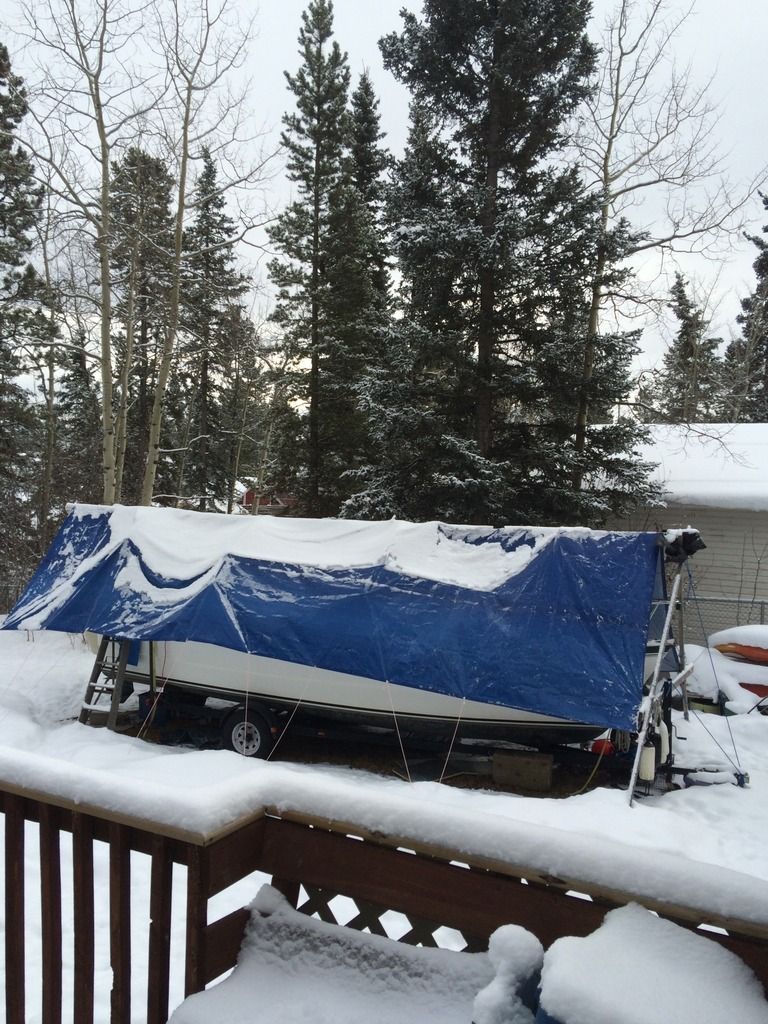

This is what we do. It had just snowed a few inches but this morning all that snow had sloughed off without any help from me. Although most time I still hop into the cockpit and knw it off from teh underside which has tons of room. This set-up also allows more room to get the boat out in the spring as when we put in there's still lots of snow on the ground. Also out it up on stands just enough to take the pressure off the springs and tires.

That Tarp you have is just the right size ... Could you please tell me the dimensions?
