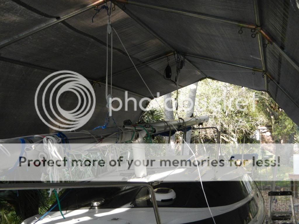

bobbob wrote:Do you have a picture of the support you are mentioning? I'm curious, although as I said - I always have a second set of hands, of the Mrs. kind![]()
I can't quite see how the mast would ever rotate while trailering - perhaps this is anphenomenon?
http://www.macgregorsailors.com/forum/v ... CH#p261395
I don't have a picture of mine but I will try to get one. Here is a picture of fishheadbarandgrill but there are even better ones of the fishheadbarandgrill mast crutch out there on this site but I just don't know how to find them

Thanks. I was thinking of something like that for over-winter to prevent the mast from sagging if a lot of snow or ice were to stick to the tarp for some reason. I suppose you would bolt this into the mast saddle?

Yes, it uses the same hole thingy as the mast - you just slide a bolt in - that's where I store my spare.
The mast on the M boat does not pop up in the air - it's a lift job all the way to the mast step. I guess on the X the aft crutch is too far forward. (?)
