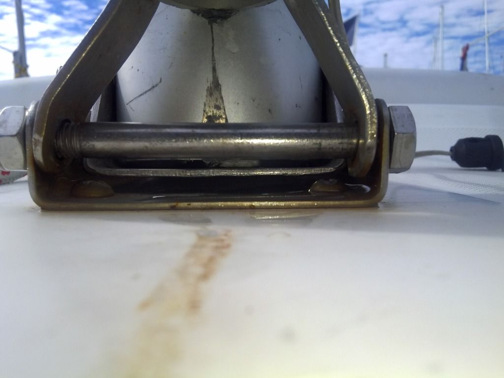

I'm seeing a strange issue with my mast step. Firstly the mast step is not flat - so you can pretty easily put say a flat head screwdriver between the step and the deck plate. I would say toward the front of the boat there is less than 1/4 inch of this situation between the step and plate but it concerns me either way. Should this be at an angle or is the rake built into the mast step hardware? The bolt is through so the rear is in the correct position.

I apologize for the night photos but they show the situation. Basically it is good in a way there is some play in this - about 3 credit cards high can go in 1 inch - or 5 credit cards can go in the very end... because if the mast is to have any movement forward, and if it were flat, this would not be good for the structure.
I'm curious what other 26x owners see at the base of their mast.
Here you can see I'm full out on the backstay... I can probably go one more on the vernier with some effort.
Someone will find this funny as well... a boat is a reverse ATM machine. My 26x is OK though, do everything myself on it..,
I guess my concern is the weight distribution is primarily on the forward bolt, not completely on the flat stainless steel plate.

Looking at your pictures something doesnt seem quite right, or maybe straight? Looks like the step is on an angle, it may just be the pic? I just took some photos of mine, my MRS is still attached so look beyond that, the step is nice and parallel to the deck and looks to have maybe 4mm clearance, maybe enough for 2 or 3 credit cards tops.

Mine has a bit of a gap at the front, though I didn't measure it.
My mast has less than the 4 degree rake specified in the manual, though. Less rounding up. Hard to tell what the actual angle is from a photo, but I know it's less than 4 degrees (which is a lot).
As to structural issues, it's not going to make a difference to the mast. Many other things in play there, but buckling due to eccentric loading isn't one of them.
