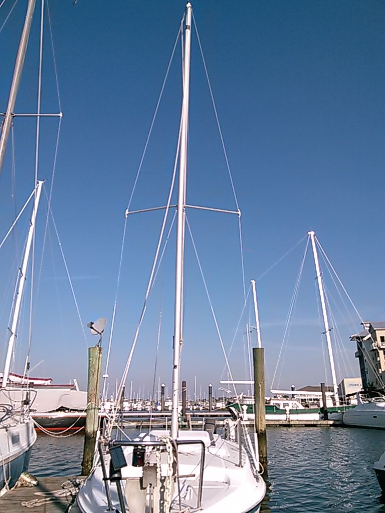

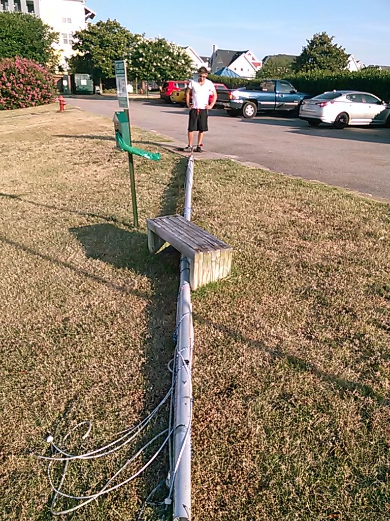

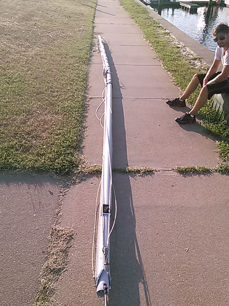

Had a Mac 22 buddy meeting me on the water call and say he had an problem...caught a shroud on the way out of the marina. It pulled the spreader straight back and bent the mast into an S shape with extreme tension on one side and the other hanging slack. It didn't look good but wasn't kinked. I had doubts but being optimistic said we could probably fix it. We went back early this morning and took the mast off to give it a try. I think to amusement and slight disappointment of the live aboard skeptics we used a bench to straighten it and were out on the water and sailing by 9am 8)

Seapup, if you get a chance talk to a mast-type-dude and ask whether a little propane torch re-annealing on the location of the bend might prove beneficial. I would think that spot would be weakened due to the bending and the subsequent straightening.
Maybe you could bring in a carpenter for the bench seat at the same time! :D
