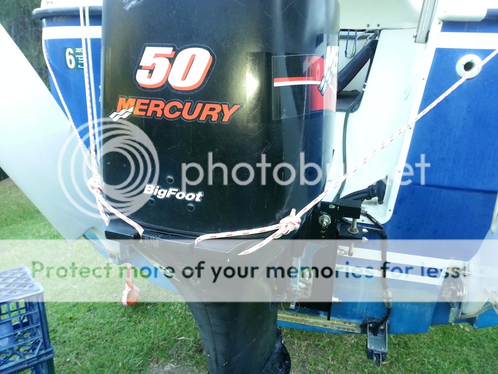

I've been losing sleep about my rack an pinion breaking and leaving me stranded :?
So here's my cheerful (and very cheap solution) .... My setup is for an :macm: with a Merc BF4 but I'm sure this can be adapted to the :macx: and other OB's.

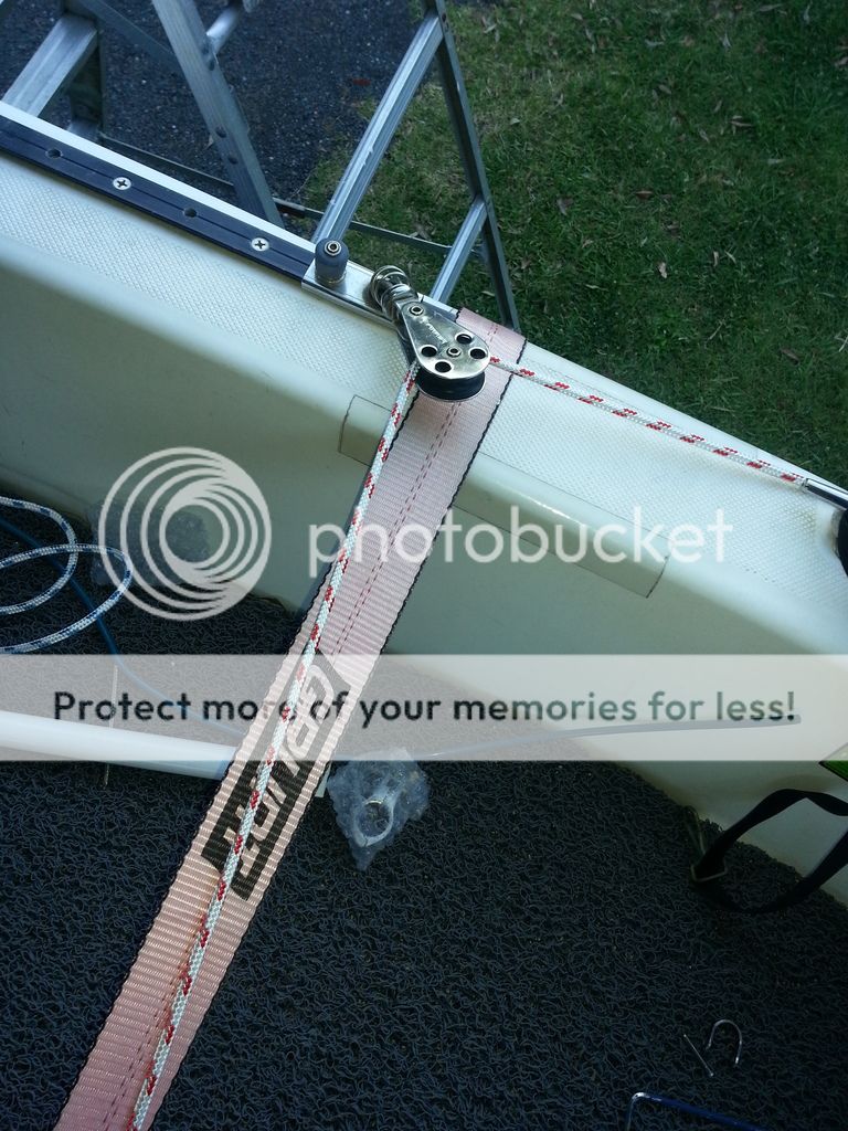

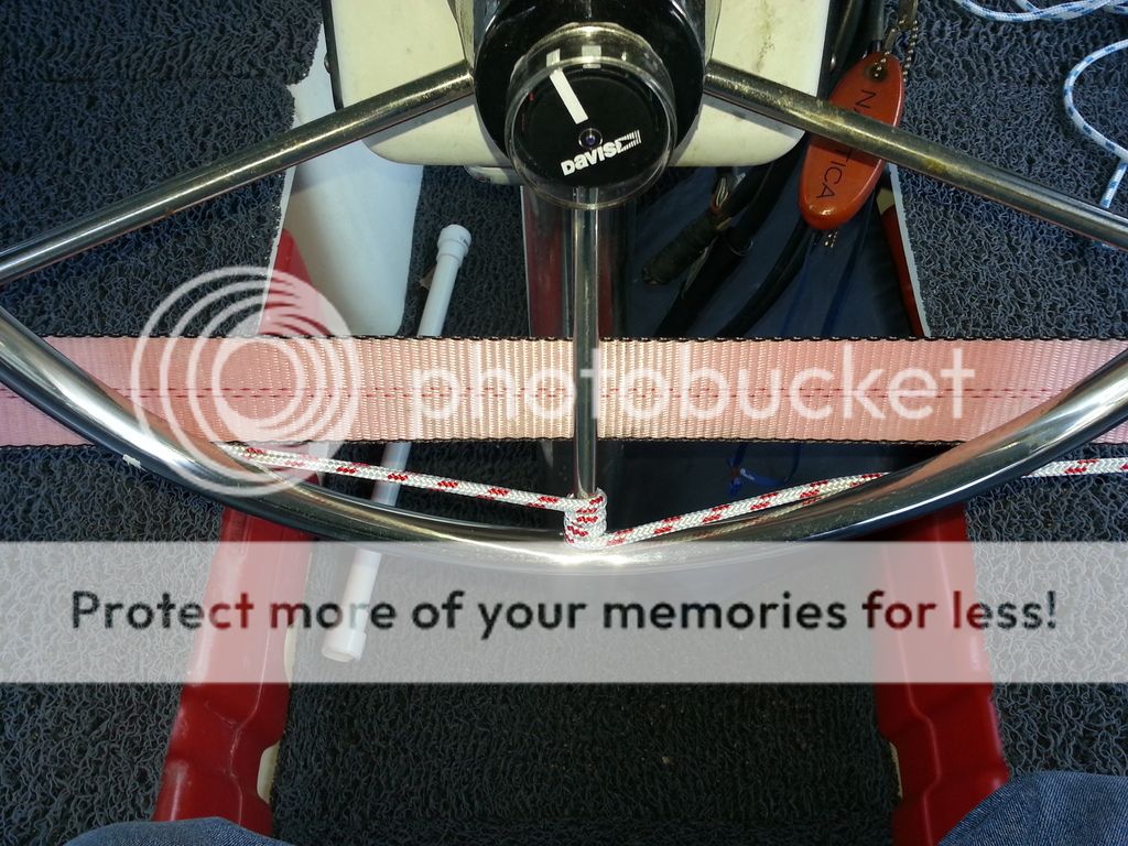

Just one rope (6mm / 1/4") about 6.5m (21ft) long and a clamp / clip is required.
Move the Genoa blocks to the back of the tracks. Wrap your rope 3 times around one spoke of the steering wheel. Run each rope end through the blocks, then outside the rear stanchions and straight to the back of the OB. On the BF there two tongues at the back of the case (where it meets the cowl). Put a loop on one tongue and the then ensure the rope is tight before looping the other. Put a clamp or clip on the 3 wraps on the steering wheel spoke (or pinch with your fingers) and the jobs done and works a treat :D
A 90 degree turn of the wheel turns the OB about 30 degrees but thats not enough to drop the loops on the OB.
Hope these photos speak a 1000 words ....

I just went outside to try it in the rain, here's my on-the-trailer review...
First attempt: Wound line three times around steering wheel spoke and secured with two zip ties. Because of the location of my gen car tracks, this pivot point was located equal to the front of my helm. I routed the lines around the aft most rail stanchions. Because my Tohatsu does not have the same mid section design feature as the Mercury shown, I removed the cover and attached the lines to the lifting ring aft of the flywheel (dangerously close dif the engine when running). I was able to get about as much travel as Neo, but with great effort, considering how close the engine attach point was to it's point of swivel. Disconnecting the steering cable from the steering yoke eased this some. Eventually one of the zip ties broke due to strain.
Second attempt: Routed the line thru the gen cars ahead of the helm. No steering wheel this time. With engine cover on, tied lines similar as Neo, but with big loops around engine cover and mid section with a bunch of trucker hitches and notty knots. Stood at helm and pulled on lines directly. Steering travel, tho a bit awkward, was max each way and easier than doing same with the steering wheel.
Conclusion: Great creative solution for a problem no one hopes to experience. YMMV. Everyone should consider/practice contingency options for this scenario before having to figure it out when TSHTF!

mdbrown wrote:Another option to consider is a boat hook/pole and duck tape. not as elegant but it will get you home.
On the :macm: its a fairly narrow opening to the pit/OB and a pole/tiller would not turn the OB very far.
K9Kampers wrote:Routed the line thru the gen cars ahead of the helm. No steering wheel this time. With engine cover on, tied lines similar as Neo, but with big loops around engine cover and mid section with a bunch of trucker hitches and notty knots. Stood at helm and pulled on lines directly. Steering travel, tho a bit awkward, was max each way and easier than doing same with the steering wheel.
Thanks K9.... Pulling two ropes was my initial inspiration but I was concerned I'd pull them too far and an OB loop would come off ..... But Catigale's idea of the zip-tie stops that.
Also, I have a larger wheel on my :macm: so if anyone has the original size wheel it may be better to pull two ropes.
If disaster ever strikes it would be kinda funny pulling into the marina looking like Ben Hur in a Chariot :D
ALSO, also.... If anyone else has devised their own "Get out of the Sh*t" procedures please share those with all of us, in a new thread.... No joke, information like this could save a Mac (or a life) one day.
