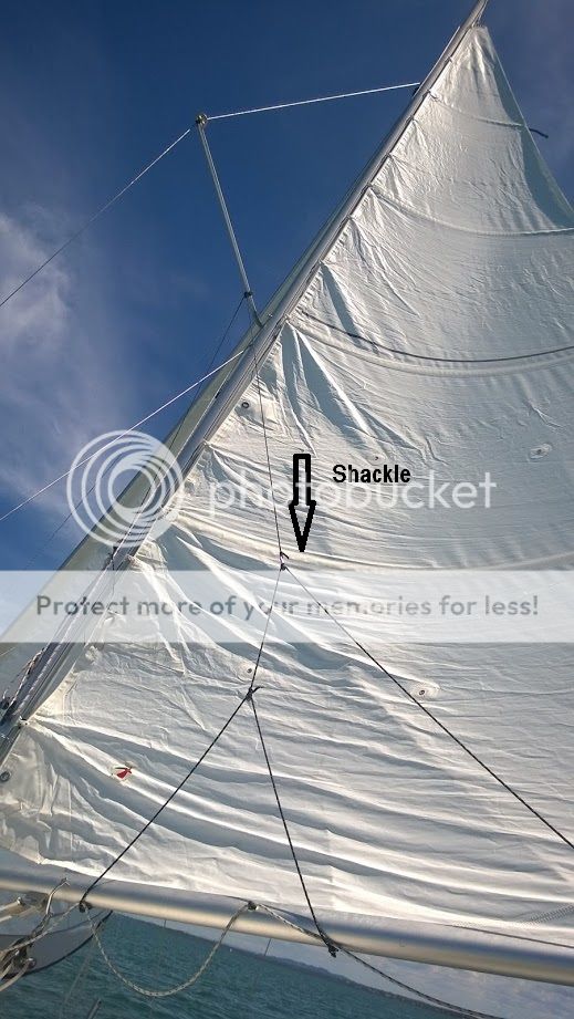

Phil M wrote:How long does it take to set up and take down lazy Jacks? My setup and take down procedure already seems to be long enough. I have shied away from lazy Jacks for that reason.
I put a shackle on the main line of the jacks and quick pins on the spreaders, I remove them too, it takes an extra 30secs per side and the main is already setup and ready on the boom. Unlike sumner i put my fairleads directly on the spreaders . A lot less time than unbagging and fitting the main each time. 8)

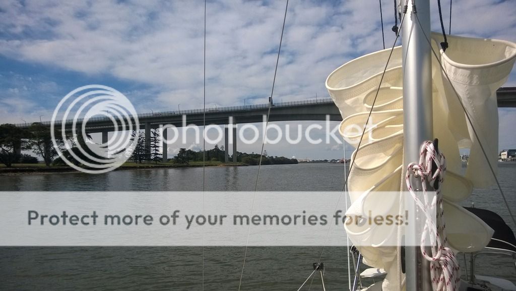

Here is a picture again of how the lazy-jack lines run at the spreader/mast area and a quote from my page on the lazy-jack installation...
Right before the trip I added the small cheek blocks to the mast (top arrows). Now there is virtually no downward load on the spreaders as the blocks there just hold the lazy jack lines out some. I don't think there was much load before since..
.... we use a topping lift (arrow) that supports the boom when the sail is down, but if I was to forget that line and not have it adjusted right the weight of the boom/sail would be on the lazy-jack lines. Now there is no worries that I'm putting a downward pull on the spreaders.
Once I set the length of the topping lift and the lazy-jack lines they usually aren't touched until the end of the trip when it is time to lower the mast. At night on anchor I pull the boom to one side and connect it to the port side of ...
... the forward solar panels to get it out of the way and to keep it from swinging around on anchor,

Whereas you (Kadet) put fairleads on the spreaders only?
Yep these in fact :) I have a boom kicker so no weight on spreaders.
Line runs from lazy jack cradle block with a shackle up to the spreader fairlead then down to a jam cleat on mast. I leave the line in place on the mast and spreader and the cradle attached to the boom. When disconnected from the jack cradle there is enough slack to allow the spreader to be unpinned and strapped along the mast out of the way. Boom sail and jack cradle are then stored as one below :)

I used 4mm 16 braided bought a 25m roll on sale at Whitworths for like $25 years ago and still have bit left on the roll. I used Riley RM302 Bullet Blocks, 14mm x 6mm, for the jack cradle.
I have them that far out to prevent the battens jamming when raising the sail and so I don't have to slacken them to prevent interference when under sail. They are stanchion fairleads so can moved in and out till you find the sweet spot :)
Under the boom I just pop riveted on some stainless balustrade saddles to lead the lines through. The front inverted V is one piece of line for both sides lead through the saddles and a block each side. The rear line is a single piece that is tied to the front block and passes through a block that is shackled to the spreader lines. So there are two lines from the spreaders one line for the 2 parts of the front of the cradle and one line for the single rear part.
No the lazy jacks are just placed on top of the the flaked sail then the whole lot is sail tied with proper webbing straps with buckles.
