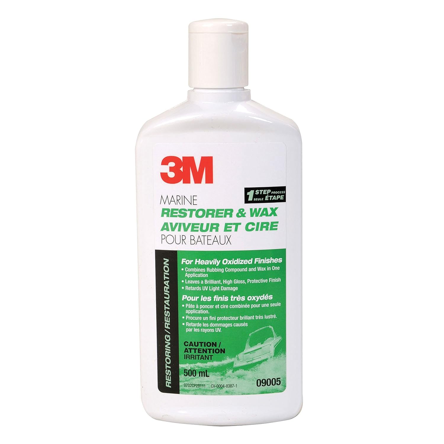

Re: Claybar on the Racoon Stripe anyone?
I doubt clay bar would fix oxidization. My understanding is it's mostly used to remove particles of contamination embedded in the surface.
My black stripes looked terrible. Gray and faded very light. They looked really bad.
Then I tried this 3m restorer stuff with a rag. I first applied it in the hot sun and it dried so fast that it left streaks. I wasn't impressed with results.
Then I broke out my buffer with wool pad and WOW! The black looks brand spanking new and shiny. Amazing stuff.
I wish I took before/after photos. It's not applied like wax. You pour it on and buff it off and it leaves new fiberglass. All I can say is this stuff is amazing.

The "3M Restorer & Wax" product is also a good one, as noted by those who have used it. However, instead of this single step product I prefer to use buffing compound, clean that off thoroughly, and then apply a carnuba-based wax like Mother's. Either should work well, however.
