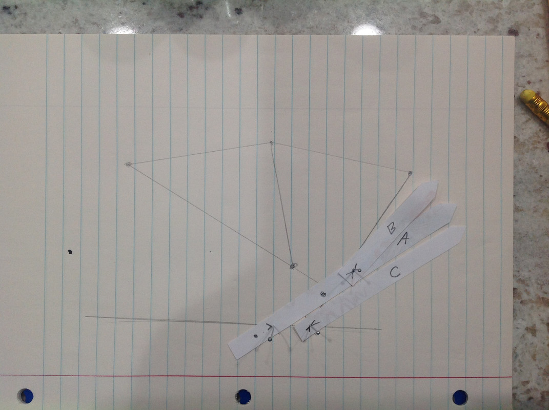

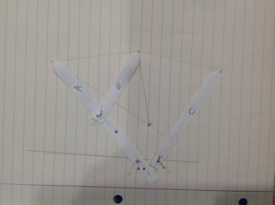

Bimini Up
Bimini Down
Tom does much better, but maybe this will give you the essence of it. "A" gets shorter and pivot point moves to deck. "B" and "C" stay same size, but pivot point of "B" moves upward on "A".
Scaled from your photo, so not highly accurate; but looks like the concept would work.

Shouldn't have to modify the cloth at all if it's done correctly. You have to measure everything accurately, draw a scale model of the top as-is, and then design the modified support to fit the top. During this process you have to rotate the members through their range to make sure everything works for your top-up condition as well as your constraint of fitting in the storage sleeve when down. I didn't know what your stored position was, so further adjustments to the concept may be necessary. Remember, I was scale modeling from a photograph, so this is conceptual only!
If you have a spare set of bows, you could leave your top up and experiment with spare bows and duct tape, or masking tape, etc. - if you are more comfortable with reality than scale modeling.
If you look closely at the crude concept model, I used pins at the pivot points to allow me to move the members through their range.
Again, I would want to put the boom up and work with that constraint- if it was my boat, but, your boat - your choice.
