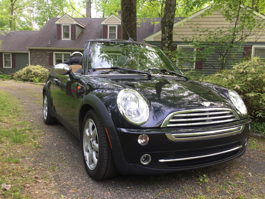

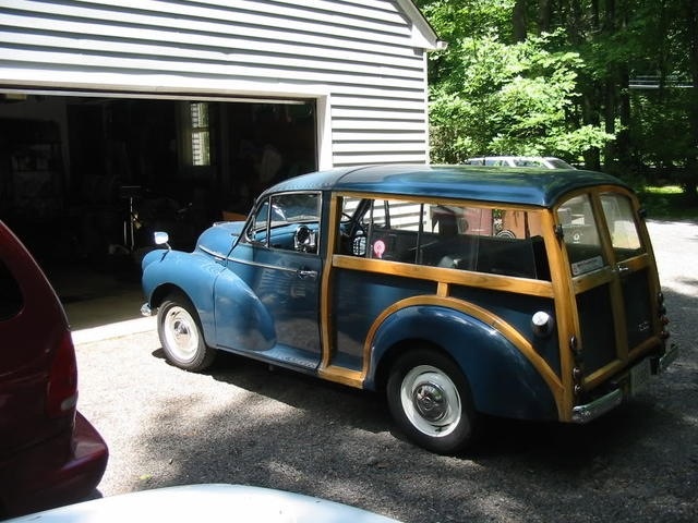

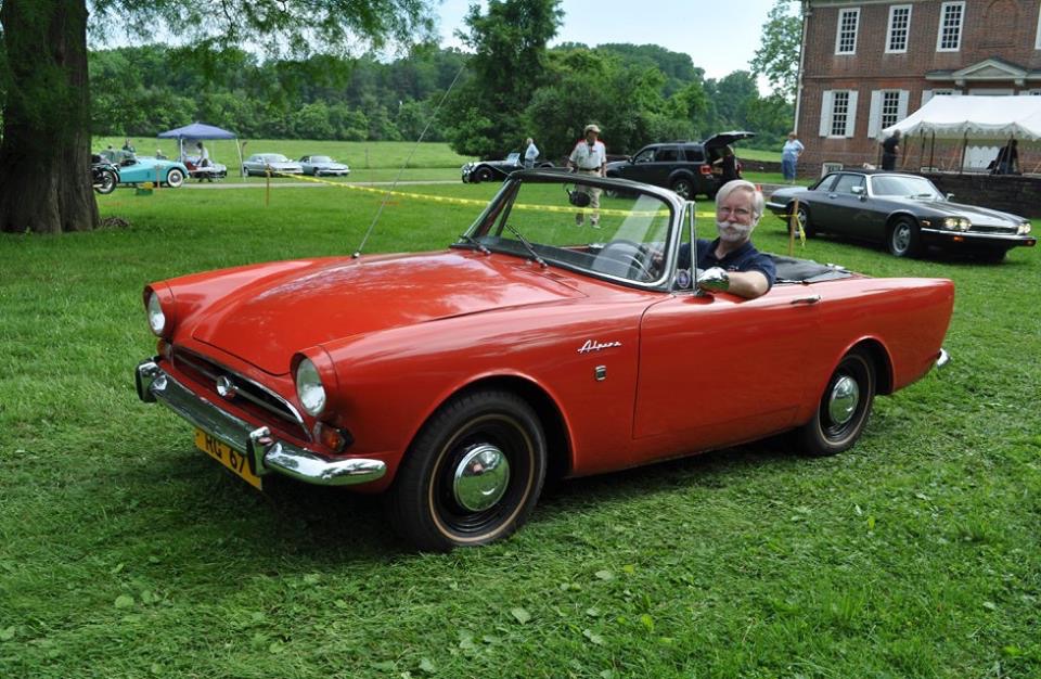

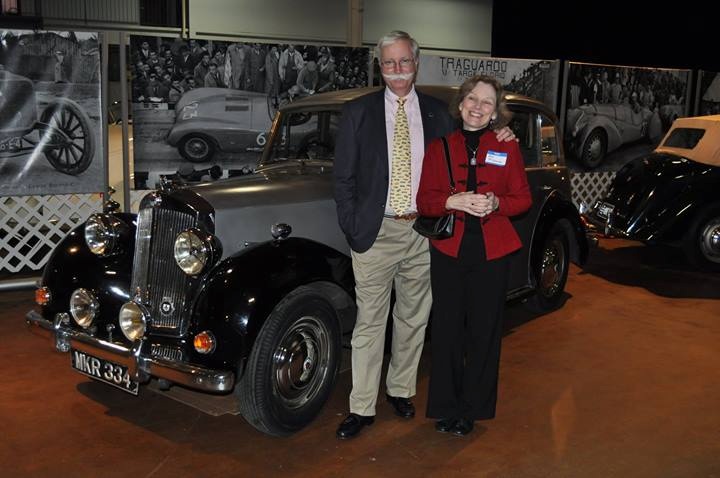

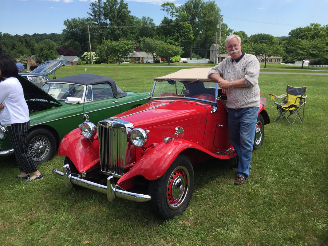

If so, I’ve hit my hand...A LOT.... 47+ times over the years. The stable has been whittled down to only 5 at this point:Tomfoolery wrote: ↑Wed Aug 26, 2020 5:21 amYeah, but like hitting your hand with a hammer, it feels good when you stop.![]()

Those are beautiful! I could learn to live with the hammer if those were the reward!

Thanks... but it took a LOT of hammer strikes to get them there!
