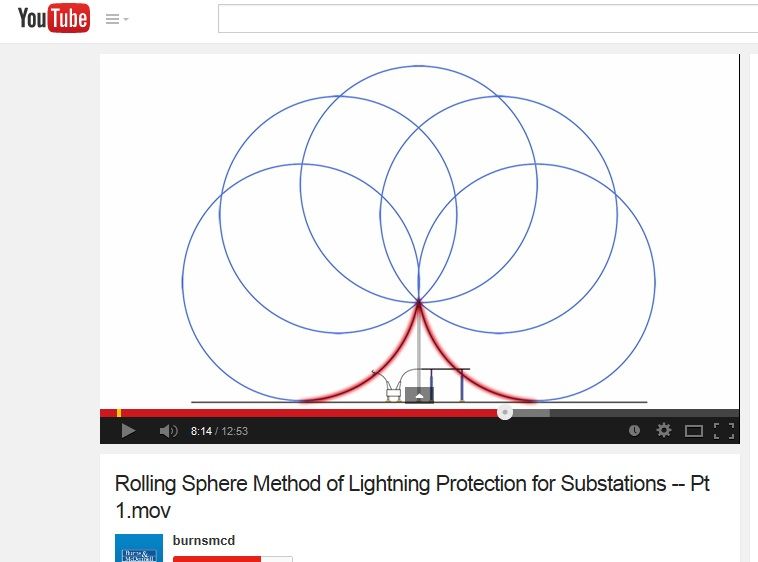

(two parts since only three images per post)
At 8:14, an example protection wire and equipment is shown. The protected area is under the red.. very clear. Anything outside the red is not protected. In that example, there is a portion of some equipement on the right side that is outside of the protected red area.

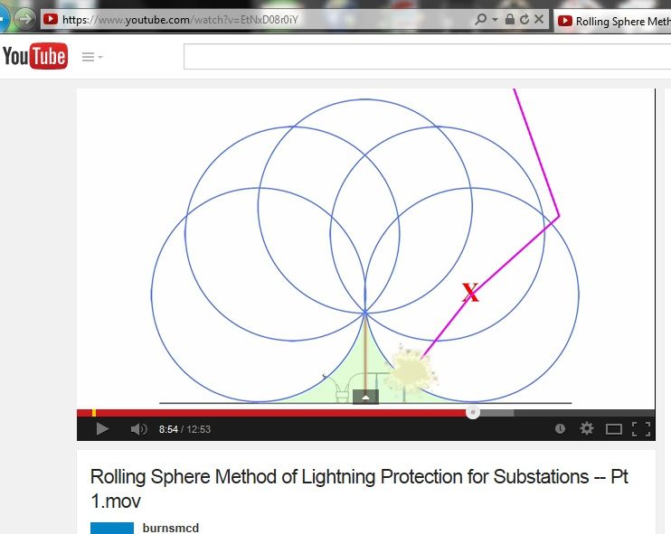

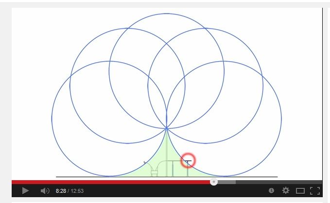

The next two pictures are at 8:27 and 8:54
What is said on the video in this section is that the area under the green is protected by the wire but that the piece of equipement shown by the red can be reached by a step leader instead of the protection wire. The red piece is outside (the green protection area) and is potentially subject to a direct lightning strike.
Now go back to the picture you posted in the section where the guy is leading into the discussion of how things work "asking what about". Your conclusion that things inside the sphere wont get struck is inconsistent with everything in the discussion area.
And how this relates to anything ungrounded is just not at all in that video (unless you look at that picture and don’t see a ground symbol on the lines drawn :cry: :?: )

Nice job of cherry picking with that last picture, Walt. If you rewind just before it, they show and demonstrate that the strike current of the strike that hit the bus was of a specific magnitude, such that it could not reach the grounded mast/wire, or reach the ground. But it was of sufficient magnitude to reach the buss. If the current had been less, it would not have reached the buss; if more, it would have gone to the mast, or to ground. I don't know if you are purposely misleading the forum, or if you really don't understand.
