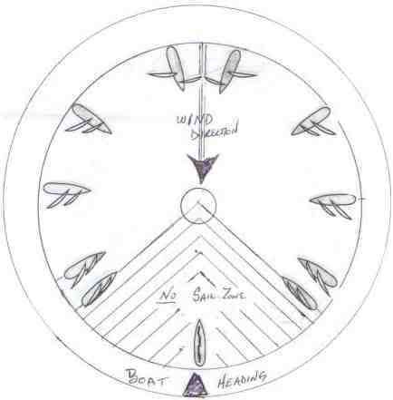

Thanks for the points of sail, It gave me something to toy with while monitoring a boring process. I have often thought that to help the sailors who are perceptually challenged aboard to trim things, I would put a chart at the helm like the points of sail, but PoS really isn’t helpful when they are trying to strike a heading and figure out where to put the sails. So I cut up your image and pasted it onto a CD-rom and added an outer cutout (actually a tracing of the bottom of the CD holder). Now if you rotate the inner circle (the CD with images attached) while pointing the heading where you want to go, it gives a quick visual image of where to start setting the sails. Of course I will clean it up, but I like it for showing my family members what’s happening.

Tangentair,
It looks good 8)
When you decide to market it, make certain we get a steep discount :)
