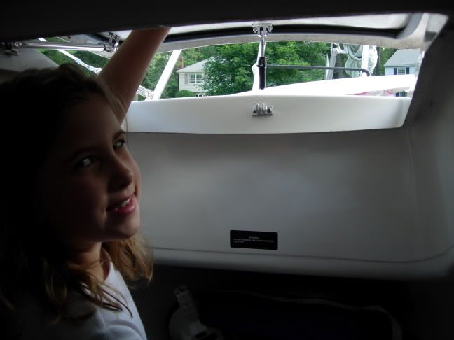

KM - I put on a cam action latch on the front hatch and its much easier to operate - Ill put up a picture - also you might search for my mods as I might have put up a picture ??

Hatch Latch 1
Hatch Latch 2
I managed to use some of the existing screw holes, had to drill two extras and fill one in.

She's a real cutie, Steph!!!
Nice latch, too. :)
