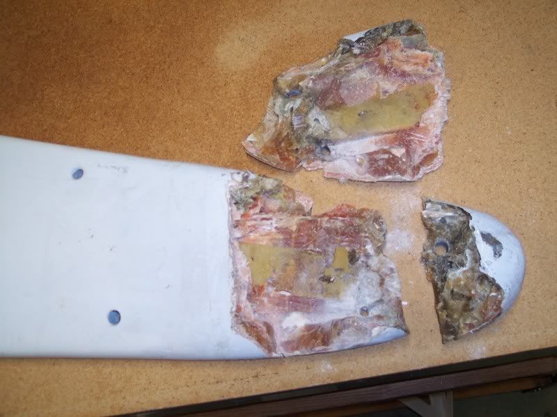

As for the X, like Zoran, I've had 2 failures. Always on the lee side. First time was from Oriental to Ocracoke. The Pamilico Sound was about 4-6 feet and wind was probably around 20 kts. Full main and 150. After docking in Silver Lake, I noticed one of my rudders looked a little weird. Pulling it up it wobbled like a broken limb. Broke near the pivot bolt. Unbolted, took it home, reglassed it.
The second time was from Chub Cay to Andros Island over Tongue of the Ocean. Winds probably around 25 kts. and seas well in excess of 8 feet. I accepted I was part of the problem as we were surfing some of the waves reaching speeds of 10.2 kts. with 150 only.
Upon anchoring behind Morgan's Bluff, I discovered the same rudder problem:
As stated earlier, the rudder is 2 thin fiberglass pieces filled with resin at the head. No real strength. You can see the foam core in the pic.
The other X with me, Luke's DreamChaser carried a spare and offerred it to me as I was carving one out of a board with a machete. LOL
BTW, Luke had the earlier ss rudder brackets and both broke but rudders themselves remained intact.
I ordered 2 new rudders from MacGregor and so far haven't had the problem re-occur. (I also carry a spare now.)
So, FWIW, there has been some X rudder failures.

Well I got my rudders back from IDA sailor marine. They basically chopped off the top portion where the rudder broke and recut that area, on both rudders of course. Good as new and they're only just a bit shorter. Now 51 inches.
I am replacing the damaged bracket along and drilling additional holes in them as well as the rudders. In the down position, I will insert a bolt an tighten w/ wing nut. This should accomplish a reduction in sideways movement, using the support of the entire bracket rather than just the top part which has the pivot bolt. It will also prevent the rudders from trailing aft due to line stretching when under heavy load. It will be a bit of a pain to bolt and unbolt every time I want to lower and raise rudders, but I think this is the price to pay for carrying the added loads due to the bigger blades. Hoping they'll stay in one piece for a long while.
