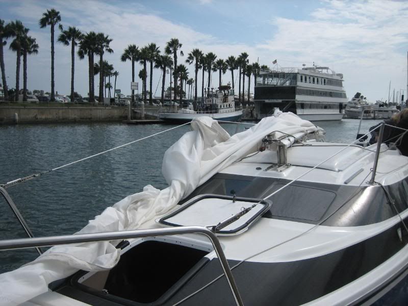

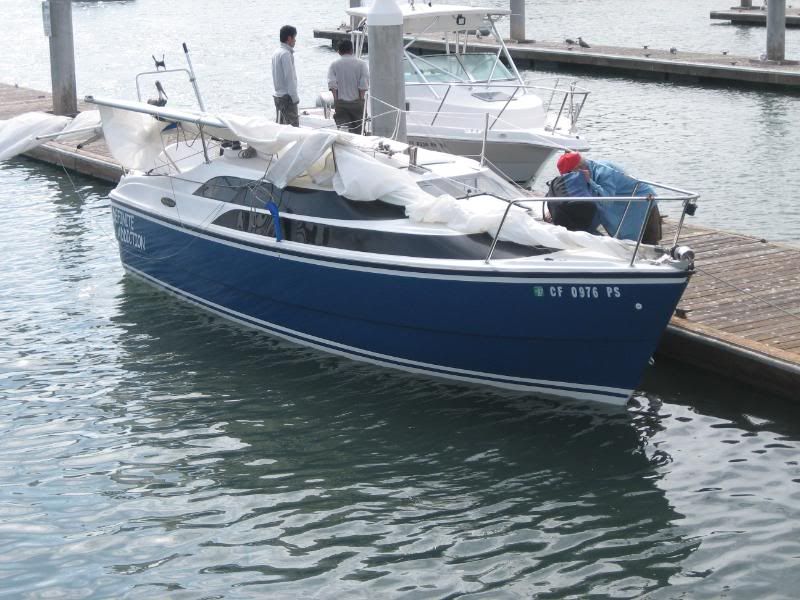

Saturday, 15kt steady W winds, 3-4' swell, 75 degrees, 4 crew, 3 hours Marina Del Rey to Palos Verdes Point, 3 hours back on a port tack close-hauled - all was nice until we heard a loud snap! I looked up but didn't see or feel anything, so what was that? We kept going. But then, the boat started getting sloppy. She kept wanting to head up. More and more opposite helm until we would stall, fall off, I'd straighten the helm, we'd gain speed, and then after a few minutes, the same thing would happen. It got worse! I've seen handling like this in heavy winds, but I looked around and conditions were still nice. I tried a broader reach but the same thing would happen! The heading-up frequency was getting shorter until finally I was going to give up; I put the motor down and started it. I woke up our guest who was sleeping on the starboard side of the cockpit so I could open the fuel tank vent (I have to close them when heeling to keep gas from spilling). She moved to the windward side of the cockpit, I fliped the seat back down, and THERE GOES THE JIB! Just as my brain was registering this, THE MAST CAME DOWN! It torqued down in an arc to starboard and somehow I ducked and the starboard spreader slammed into the cabin floor inches from my foot. Image

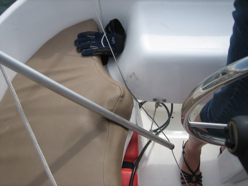

The port spreader hit the port lifeline and bent the rear stanchion. This was not good, but nobody was injured. I headed up into the wind and my crew helped haul the jib and main in. Because we were close-hauled, the sails didn't go in the water.
We made a distress call and the guests put on PFDs. After a few minutes of struggling, we had the situation under control and we canceled Vessel Assist. We were lucky in so many ways. First, no injuries. It was daylight, was had great conditions, and we were only three miles from MDR, straight downwind. We limped in, trying to control the main and keep it from opening. We lashed the mast to the rail, and used the main and jib sheets to tie up as good as possible. Three sailboats, one really large, asked if we needed assistance and a lifeguard boat shadowed us into the breakwater. Power boats roared by too fast as usual. It was like driving a car with a mattress on top, we all were holding sail to keep it under control. I can't imagine doing this in heavy winds and seas, with a long way to port. At night. In a storm. Man!

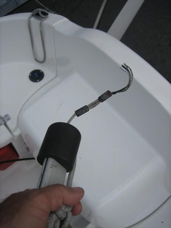

One side of the roller furler wire broke at first, when we heard the snap. It broke right at the nicro-press.
Then, for 10-15 minutes, the loop slowly expanded until only a tiny bit was holding up the mast. That's why the boat kept heading up; because the mast was coming back! Probably moved back 3 - 4 inches before it let go.

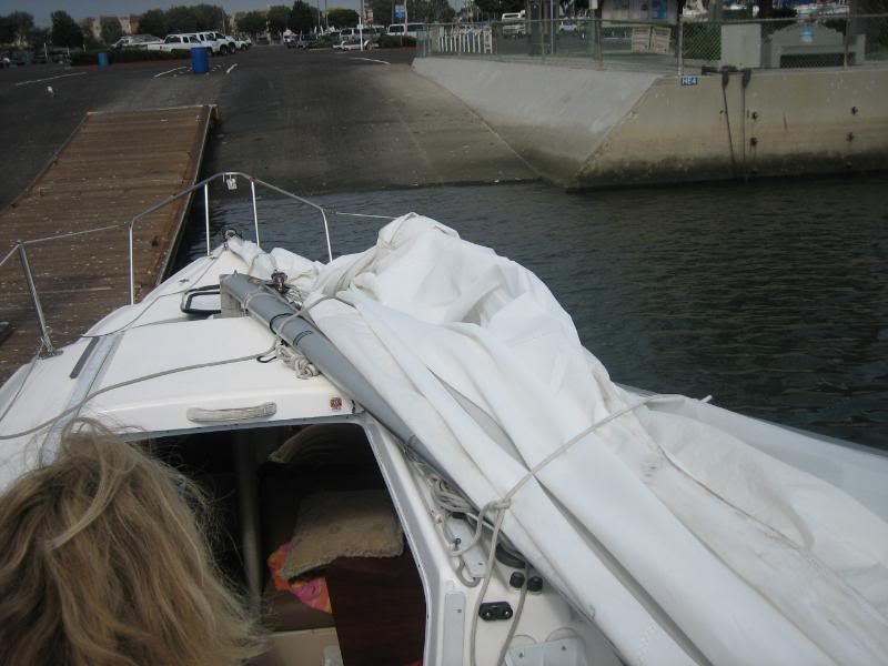

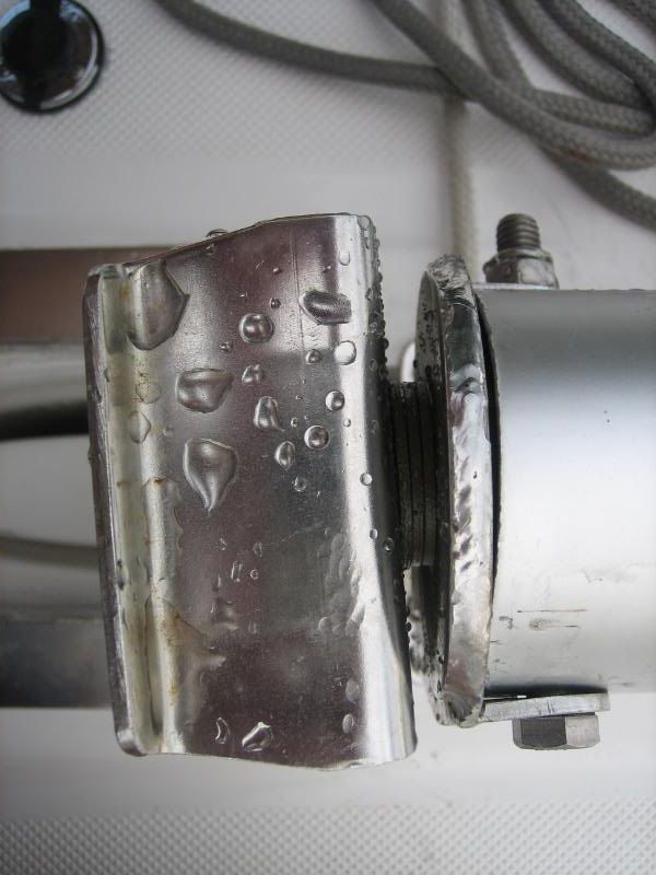

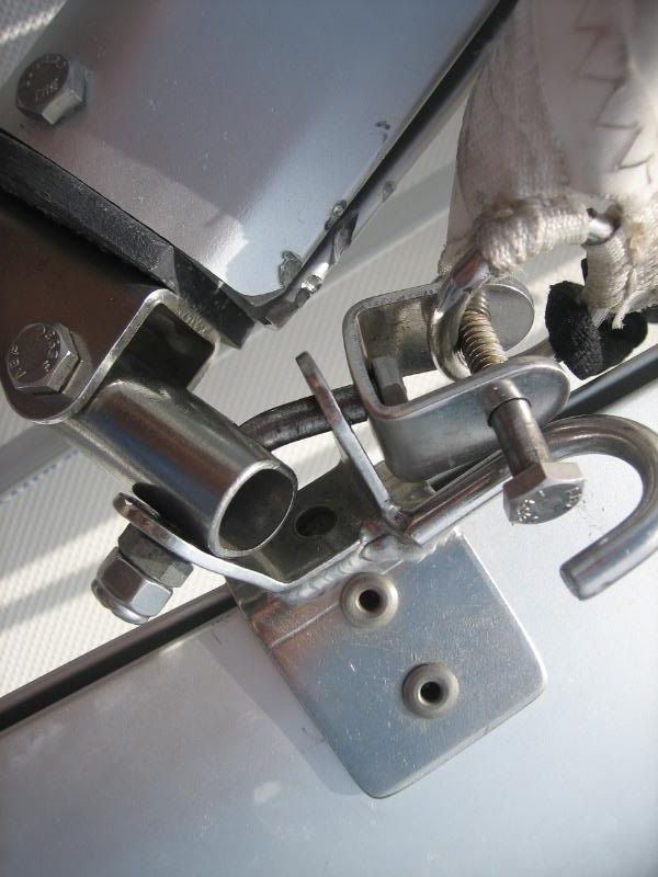

We got off pretty good: New roller furler, mast swivel base plate, starboard spreader, and mangled boom-to-mast hardware. bent stanchion, cosmetic damage to the seat from the rigging. Diane won't get back on the boat for a long time . . . (and that's NOT a good thing).
Hope the mast isn't bent, in this pic it sure looks like it.
I'm going to put a piece of stainless steel pipe over the new roller furler end - maybe this will keep the rig from buckling when I'm rigging and de-rigging. I leave the jib on the boat and tie it up in a giant S bend to the lifelines and mast. Since I trailer so much, I surmise that this is the reason for this failure. Hope that this doesn't happen to anyone else!

I think it's hasty to indict Roger for using "inferior" hardware. Facts will probably bear out that properly assembled they are a safe termination for wire rope. This is the first snapped nicopress I've read anout and we're talking about what, maybe 7-9,000 boats out there using them.
Brian Toss is pretty knowlegable when it comes to rigging and he describes them as ugly, but strong and inexpensive, when properly installed. Nicopress Swaged Fittings He would know...
Fatigued metal will eventually snap. The problem with the more expensive machine swaged fittings, from articles I have read written by surveyors, is that you can't properly inspect them because the cable is trapped inside the fitting. Oxidation happens inside the crimp tube unless it's protected from water and air. Nicopress terminations type crimps can and should be inspected often.
This fitting looks to have broken directly under the lowest swage, and could have done so as a result of the wire rope having been weakened after it was bent, possibly during mast raising, or if it were improperly assembled. Since there's a loop there the wire in the loop should only carry half of the full load... so if it were load induced I'd expect the shroud to snap somewhere else, or the destroy the crimps. But both of the crimps appear to be intact. I'd suspect the stiff furler caused the loop to flex at it's weakest point, the top of the thimble, and over time the fatigued wire failed. Note too that for extra insurance , Roger puts two crimps on each fitting.
So, consider the source generally and I don't think there's consensus that stay adjusters are less safe than turnbuckles. Yes I've had riggers berate my nicopress fittings too, and it was in their financial interest to do that. JMHO.
All rigging, adjusters, pins, rings, etc, outta be eyeballed. Stainless, despite it's name, does rust. Salt water environments are more harsh on rigging and trailers than fresh.

that is a wear failure of the wire rope,
Not the Nicopress sleeves

After Mark had loaded the boat to the trailer, I stopped by to have a look-see and a chat. I looked at the failure for any clues for inspecting my own rigging.
Once again, the "side" of the loop that broke was the long, running side, not the bitter or "tail" end. In fact, the "tail" end and both fittings looked pristine to me, in my limited opinion. All of the strands on the long, running side broke exactly flush exiting the"closest to the loop" nicropress fitting. You could not have done a much cleaner job with a cable cutter. (On edit, please, no inference intended or justified. Just trying to describe its looks as well as I can relate).
I didn't see obvious, visible corrosion. The still intact side of the loop did not show any signs of flexing or bending, it looks perfect in every way, leaving the nicropress fitting at the expected angle.
A normal loop is small and very stiff above the fitting, so whatever happens to one side should also happen to the other.
The bottom line to me is unnerving, in that no "apparent" visible clues were seen after the failure other than the break itself. Perhaps, some strands were already broken before the mishap that might have been caught on a "preflight".
But then, if that's true, what could cause any strands to break? Is a thimble normally used inside the loop?
