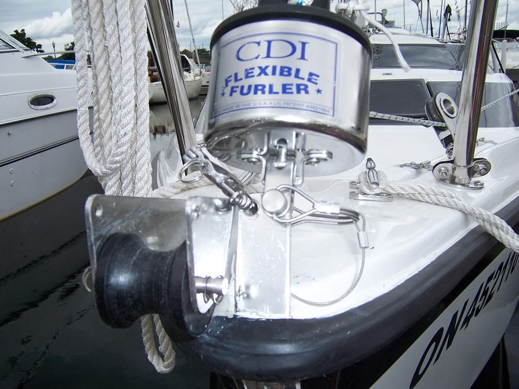

WASP18 wrote:(with the mast down) Looks like if I remove the "Luff support pin", the luff will slide up thereby exposing the turnbuckle. Is that what you meant by "it takes minutes to pop it free at the turnbuckle and slip it out the top of the 'foil'? I'm reading from the CDI Flexible Furler 2 operating instructions booklet and using their terminology to be sure that we're on the same page. :)
Yes, partly at least. The 'Luff Support Pin' marked "C" on page (2) pops out, and the drum will slide up the foil, exposing the turnbuckle. All that pin does is hold the drum down. Once the drum is slid up, you can undo the cotter pins and unscrew the stud that's swaged onto the bottom end of the forestay. Once the turnbuckle is removed, the forestay will slide right out of the top of the foil for inspection or replacement (I'd suggest replacing it - you already have one broken wire that you know of, and it ain't getting better on its own).
Page (7), by the way, has a couple of clear pictures of the lower toggle and anti-rotation bracket, under that furling drum housing. If you were the one asking about it. I've kinda lost track. :|

I removed the "Luff support pin" and I can't get the drum to slide up the foil.
Plan B (What do you think?) I'm going to re-attach the pin and put everything back to where it was. We could then use it strictly as a motor cruiser for the remaining six weeks in the season. I'll trailer it home late September and find someone who would make house calls on these issues.
I suspect the forestay would be ok considering that it will not be under any sailing stress.
What do you think?

WASP18 wrote:I removed the "Luff support pin" and I can't get the drum to slide up the foil.
What do you think?
If I read the manual correctly, you should undo the stopper knot that holds the furling line to the drum before you can lift the drum. Look at steps 12 and 13. Step 12 is what you want it to look like, and step 13 is what it looks like now. The Luff support pin is installed and the drum lowered in step 12. Step 13 is to tie the knot. SO, logically, to lift the drum for access to the turnbuckle, the knot needs to be undone as well. Just my interpretation.

This is frustrating, to say the least. I can't tell you how long it was spending the afternoon trying to get the drum to slide up the foil. I then tried to align the holes to replace the luff support pin. The actual hole(s) was a snug fit for the pin which means it has to be an absolutely perfect alignment and there is no way to align the holes because they cannot be seen. I even tried a ball point pen refill as a probe to find the hole and that didn't work.
Are these holes originally drilled by the owner or installer? If so, should I drill another hole to re-install the luff support pin. Please bear with me and my ignorance, by the way. I also don't understand how I can see the complete forestay to observe its condition when it's covered with the genoa. Sounds like I only need to see the area which connects the forestay to the turnbuckle??
The manual states (I added the bold):
"Insert the luff support pin through the hole in the furling drum throat. The luff rests on top of this pin (see picture). No hole in the luff is needed for the pin. CAUTION: the luff must not sit on the turnbuckle body as turning the furler might unscrew the turnbuckle causing dismasting."
I might not be following correctly, but it sounds like you may be trying to align the hole in the drum and a possibly non-existent hole in the luff?

THANK YOU!! Imagine spending yesterday afternoon looking for a hole in the luff that doesn't exist? :) Duh!!
It's late in the boating season and I need to expedite. I'm going to haul the boat out, take it home, remove the mast, rigging , etc. return to the marina, launch the boat and use it as a trawler. Meanwhile, I'll approach the problem in my backyard while the mast and genoa are resting on sawhorses. Reducing the pressure of getting the job done may increase my reading comprehension.
