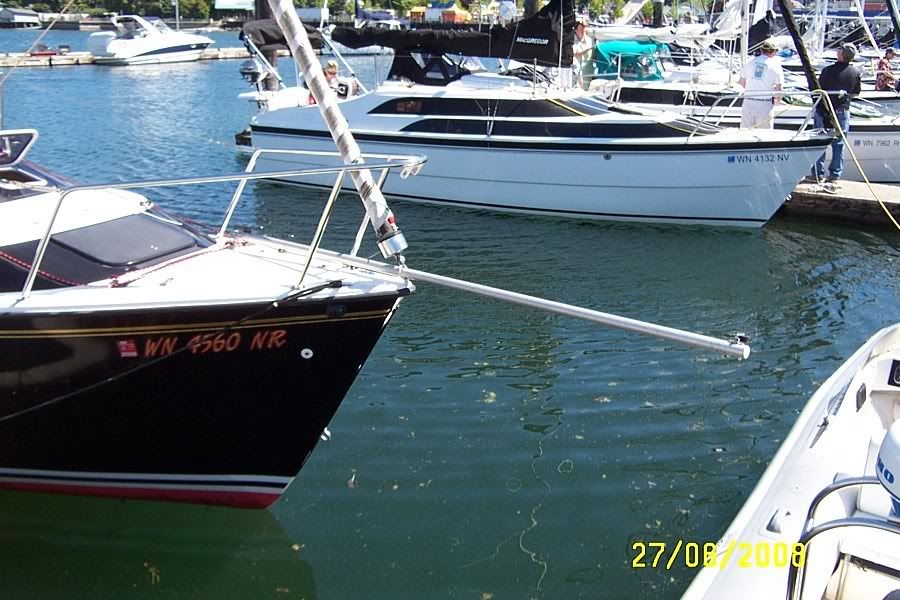

There are optional running backstays that attaches to the tracks on the sides of the cockpit. The only thing they have to be adjusted constently so the mast can rotate and to make room for the boom when running down wind and a broad reach. The only thing they really do is to straighten the curve in the jib and if raceing it might help some. I have photos
- bubba
- Posts: 896
Re: No backstay on the 26M??
Here is the Running Back-stay photo : http://i293.photobucket.com/albums/mm42 ... 8013-1.jpg and http://i293.photobucket.com/albums/mm42 ... s08014.jpg these are on Blue Water Yacht's boat the 'Black Pearl' to accommodate their 550 sq ft A-spinnaker with extendable bowsprit http://i293.photobucket.com/albums/mm42 ... s08001.jpg . On stock Mac M's these things are not really needed to sail like this http://au.youtube.com/watch?v=PxmDYpj_lo8
