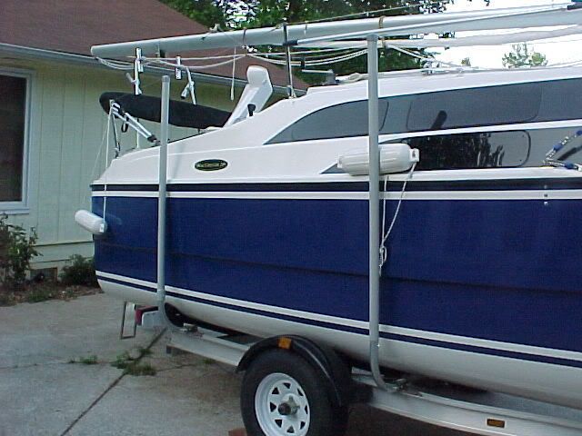

Here's my trailer:
Thanks to a previous owner I have a 2nd set of upright guides, all have been extended with PVC pipe. There are 2 eight foot long 2x4's over each wheel as well to help guide on the boat. And there's an additional bunk a couple feet back from the front vee. After redoing my trailer I've discovered that one helps push the bow up to the chock. With all of that I can really screw up an approach and still get the boat on the trailer without incident.
Also, if there's any cross wind at all I usually leave a few inches of my dagger board down to help with steering. I keep the line in my hand so I can pull it up at the last minute.

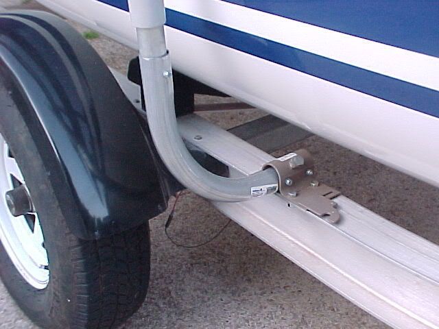

If you google boat trailer guide rollers you will get a few different types of side guides. I prefer the roller type side guides.
