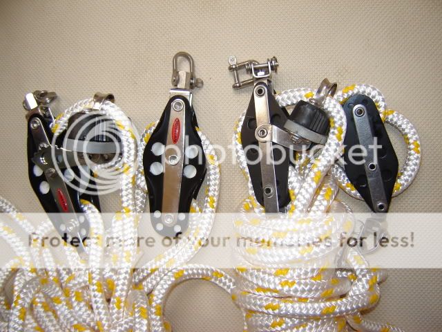

- Posts: 5995
Re: Boom Vang construction?
Here's my main sheet & preventer
Mainsheet
http://i844.photobucket.com/albums/ab1/ ... 010085.jpg
Preventer
http://i844.photobucket.com/albums/ab1/ ... 010086.jpg
here they are together for a comparision
http://i844.photobucket.com/albums/ab1/ ... 010087.jpg
I bought these from Garhauer Marine on sale @ the boat shows it was actually cheaper than buying all the componants serperately
Mainsheet
Preventer
