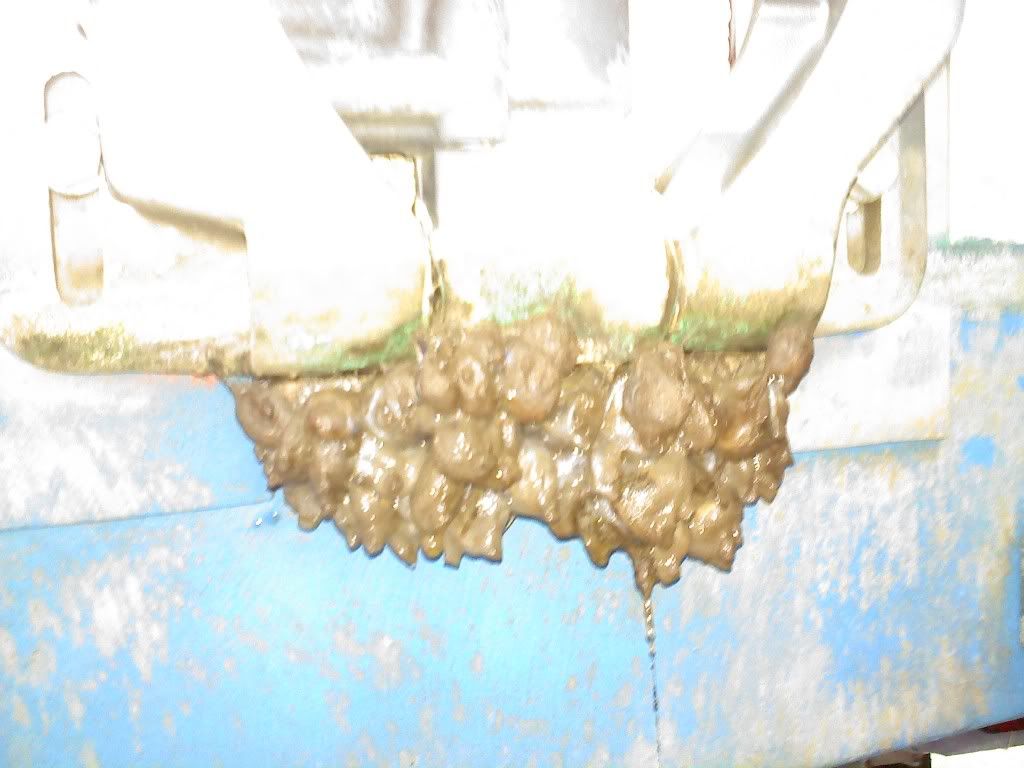

Re: Do I need a barrier coat?
The warmer the water the worse it is. Here in the Chesapeake when the water temp reaches 80 Degrees this is what you get in one week on old engine ant-fouling paint.
