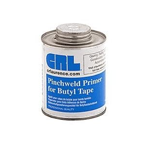

Indeed... I should have mentioned grease and oils as well. We used to clean the apertures with MEK and if I recall we even used a black butyl tape 'primer' on both the aperture and the windscreen before sticking it down. I suspect it was similar to this stuff:mastreb wrote:Watchout--Skin oil and sweat are contaminants for butyl tape, and if you get enough of it on as you're bedding, you may see these same leaks. Wash your hands before installing or consider latex, butyl, or nitrile gloves if you're doing a lot of bedding.kmclemore wrote:When I was with Lotus Cars, Ltd., we used butyl tape to install the windscreens (windshields for you US guys!) because the windscreen on those cars was intended to be a structural part of the car. Worked very well, but *only* if the parts in question were spotlessly clean. Any amount of dust or grit and that sucker would leak like a sieve.
