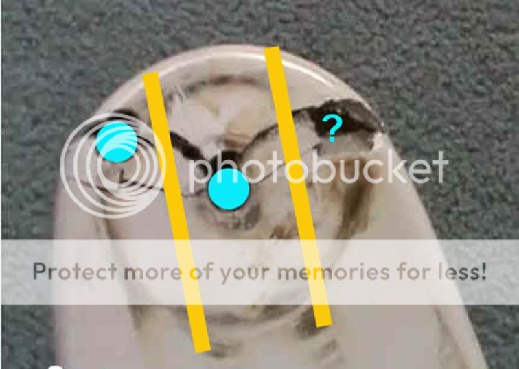

Than to stabilize the rudder I would drill in two holes of about 10mm as shown here.
Put pins, or bolts covered with GFC-paste into this holes. Again give it time to harden.
Then continue as You have described it.

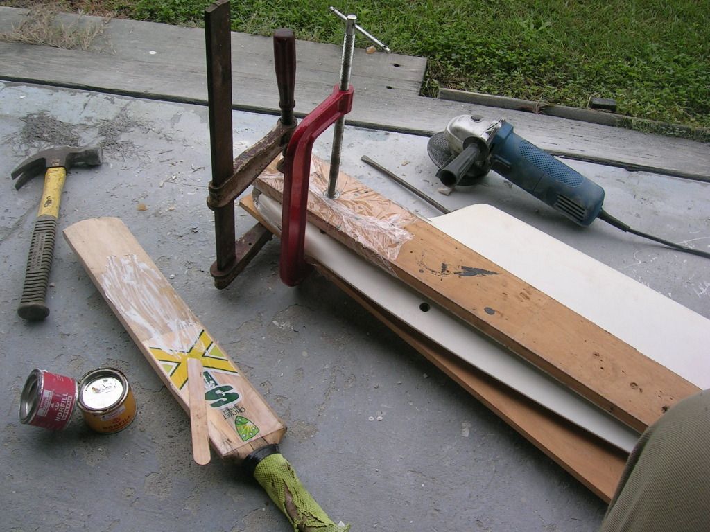

Dave, you are probably right but nethertheless, I'm giving it a go... After spending $660 getting the motor fixed last week, the missus commented, "maybe we should sell the boat!" So I reckon I'll attempt a fix, even if turns out only temporary :wink:
Using a combination of the ideas suggested. I'v ground out the crack and put a heap of filler in it and then clamped it together to bring it back straight.
Once this is dry, I will epoxy in a couple of bolts, and then grind away some of each side and rebuild it up with probably several layers of glass.
Will let you know how it all works out :|

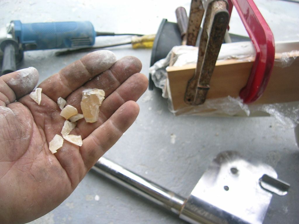

I have just taken the bracket off and straightened it as best as I can get it. I have added more filler to the rudder. Tomorrow I will take the clamps off and go buy some thin stainless bolts and drill some holes and epoxy them in. Then I will commence grinding away some of the rudder to add some layers of glass. Considering how they are made, it may even end up a bit stronger than the port side one :!: Image
The rudder seems to be just made of resin with no glass cloth,,, I wonder if the dagger board is the same,,, Am I right in thinking Roger has done it this way so they snap easier?
