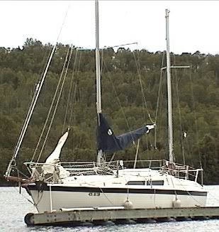

This has been done before I posted a pic a few yrs back about a guy up in Lake Superior who done this mod to his 26S/D , he shorted the main mast & rigging & changed the main sail
here we r I found it again

The idea of shortening the main mast given in the last comment suggests that, if you go ahead with the test, it might be interesting to start with a reefed main and the full Hobie "mizzen" and see what that feels like in terms of balance, perhaps even adding a reefing point less (i.e., lower) that the standard ones that come on the sail. As to rigging the mizzen itself, ours had a regular boom that extended out over the stern about a foot, but its sheet ran to block and tackle on the fantail. The waterline in the stern was a good 2-3 feet forward of the aft deck and railing so there was room with which to work a mizzen. The lack of a boom in this application might be a disadvantage given the dimensions of the MacGregor stern configuration. A "bridge" of some sort might be needed to have room to work the mizzen.
