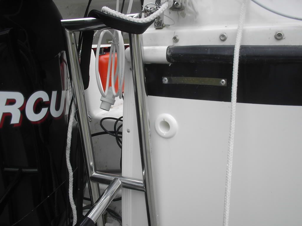

my bilge pump out is way above the water line just make sure the bilge pump is capable of pumping out as high as ur outlet don't assume it can some of the cheap bilge pumps r good for only 6" above mounted height
