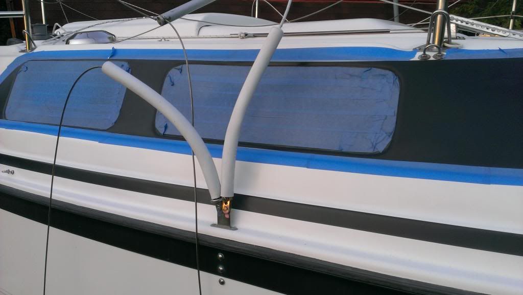

I used NewGlass2 on our bandit stripe (ha, yeah, another term for it! LOL) and have been very pleased with it. This is the second season we've used it. This year I didn't even strip the old layer. Just added 2 more coats over it and it looks great! :D
Before:
After:
