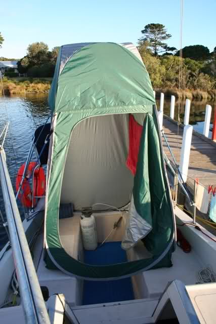

Our shower is a bit more primitive , Jack the boom right up with the topping lift and hang a solar shower off it and stand in front of the pedestal and have your shower. Not ideal, but any sort of a fresh water wash is of course heaven after a day messin about in the briney :)

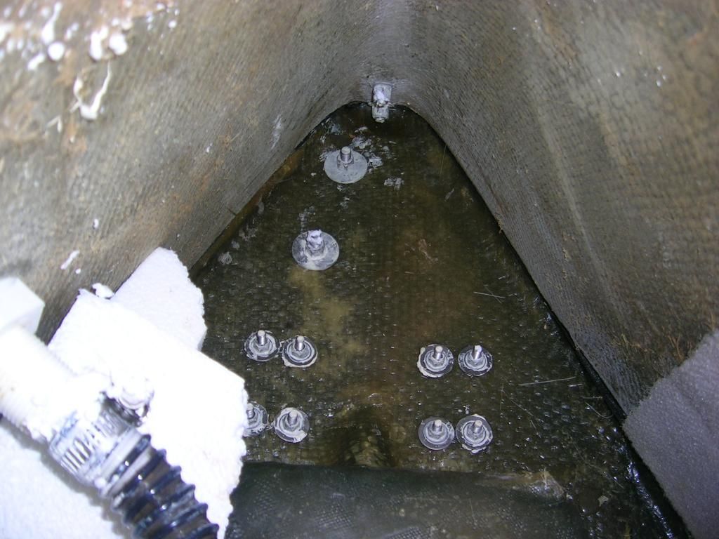

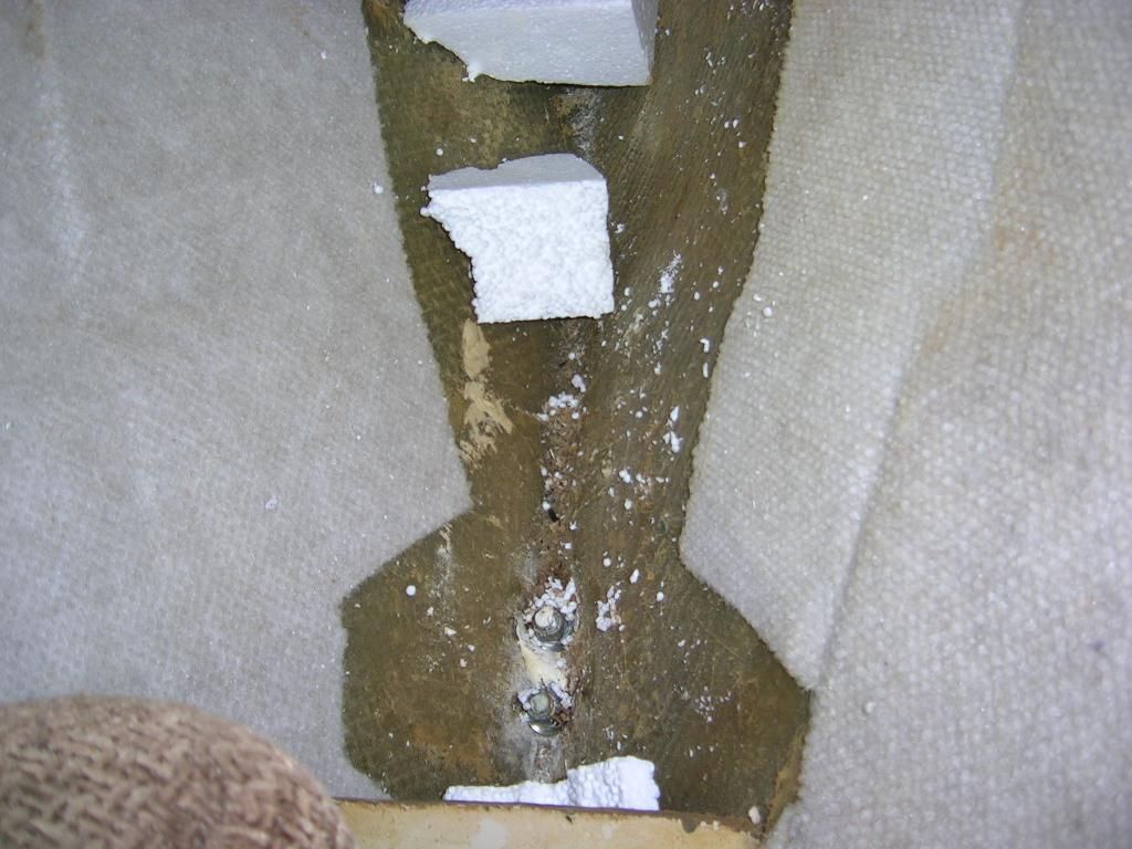

I had planned to put a new fitting on the bow but just havn't got around to it. All I did was drill a hole through the plough anchor and use an eye bolt to hold it in the standard bow roller fitting, then wrap the chain onto the cleat and into the anchor locker. Been like that for years and works well enough..
If you want to upgrade to a new bow roller and a new anchor, just get both at the same time at Whitworths to make sure they work well together. Putting a new bow roller fitting on is pretty easy. You just undo the two screws in the front of the V berth and pull out all the foam.
Then you can undo and remove the original bow roller fitting. Fill the two holes and redrill for your new fitting. Here is the bow section looking up from in the V berth.
