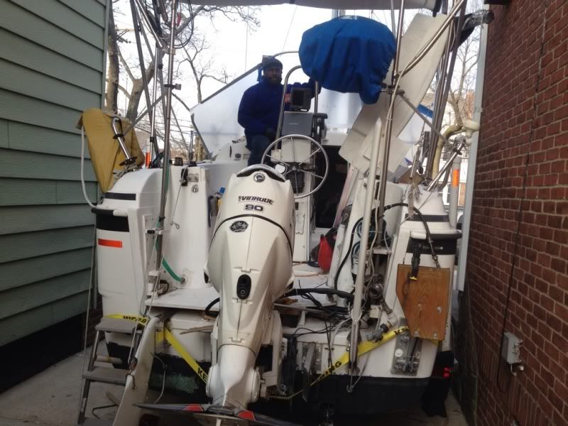

Post by DaveC426913 »
Nice swim platform!!! :)
Seapup wrote: Image[/url]

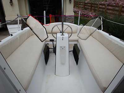

bobbob wrote: All agreed. I'd add a fifth point which is that whenever I need to fling it open in a hurry, I always almost lose the seat cushion overboard...
I have solved this, and made a new feature in doing so.
My seat cushion (actually, the back cushion) has a clip on the zipper that runs a 6-foot line to a carbiner which clips onto the stern lifeline.
Not only do I not lose the cushion, even in winds, but it means I can leave the cushion unattached so that it can come with me when I move around behind the helm.
I often lounge in the high corner, with my head in the pushpit, and the cushion makes a great head pillow.
(This is not my boat; this is Googled)

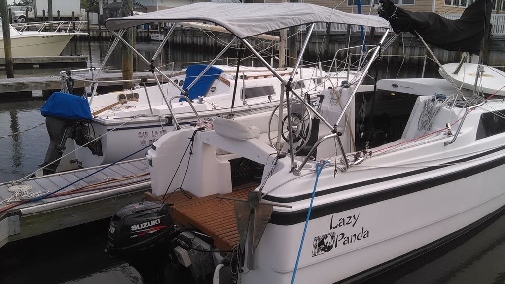

Post by Gazmn »
I have an :macx: , & I have a ladder on the Portside transom. So... I switched the hinge to the Starboard side to clear up the back while entering from the water or the trailer - port side Clear rear entry :idea:
I also cut off the horizontal part of the Capt's seat. I can still lean against, or sit on the top of the modified "transom seat" when closed :wink:
It gives a nice amount of reclaimed foot room behind steering wheel.
Image This is an old pic but it gives you the big picture...

Post by kurz »
Hi Gazmn
How are you happy with the hydrophoil?
I bought one but didn't mount already!
