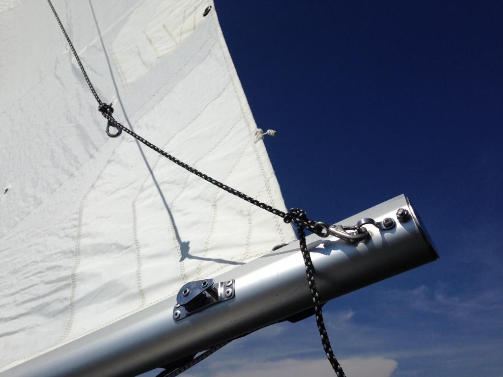

+1
Simple topping lift is cheap and easy. Her's mine.
2 adjustment points, sailing and higher when not.
Re: Opinions: Backstay and topping lift necessary?
RussMT wrote:
Tomfoolery wrote:Unlike the :macx: , a backstay probably would interfere with the main sail of the :macm: , I believe. And it doesn't need one anyway.
A topping lift can be nothing more than a length of line from the top of the mast to the end of the boom, with a means of adjustment so you can hoist it high when the sail is flaked, and dropped so it's not holding up the boom when sailing.
But a boom kicker is a nice way to do the same thing, with the advantages mentioned earlier. And it takes no more space than the vang, which works with it.
Which way you go is probably more about how much you want to spend, with a static topping lift being the cheapest but least functional, and the boomkicker being most expensive but with the most functionality.
+1
That's almost exactly what mine looks like, but I push the boom up and take a turn around it to shorten it, without ever unclipping it, at least until it's time to break it down for transport. Mine also passes over a cheek block at the top of the mast and runs down to a cleat. I never adjust it, so the block and cleat are not necessary, but the PO did it, and it's not worth the trouble to eliminate some of it, until (maybe) it's time to replace the line. I like simple.
