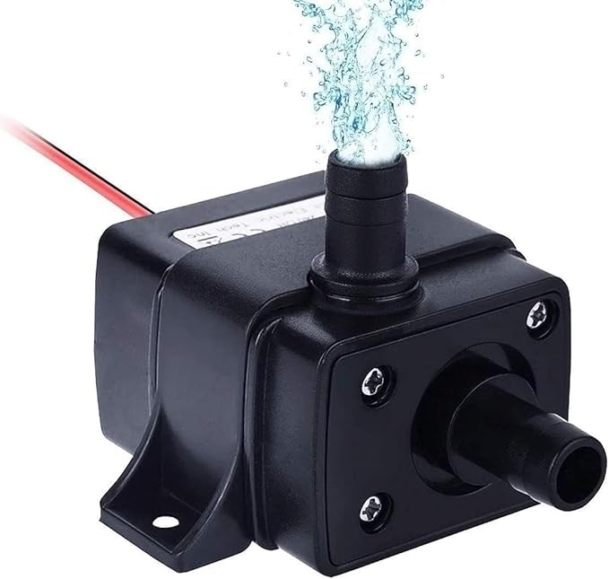

What about one like this:
https://www.amazon.com/Allnice-Submersi ... 7SRRYNGP/
(posting fixed by Admin)
MacX 2000 Honda BF50A 'SeaSaw'

DaveC426913 wrote: Sat Apr 10, 2021 11:38 am What about one like this:
The word "submersible" tells me you may have trouble priming it if you put a suction hose on it. It appears to be a small centrifugal pump. Once you get it primed, it will pump until you get a gulp of air when the level gets low.

Jimmyt wrote: Sat Apr 10, 2021 5:28 pm The word "submersible" tells me you may have trouble priming it if you put a suction hose on it.
I don't follow. I think submersible means it's water tight. It doesn't seem to have a "grill" input.
Jimmyt wrote: Sat Apr 10, 2021 5:28 pm It appears to be a small centrifugal pump. Once you get it primed, it will pump until you get a gulp of air when the level gets low.

But, if you have enough depth to get over the pump inlet level, and you put all of your hose under water, the pump you are considering should prime. Once it's primed, you should be able to move the hose around and get most of the water out - if you keep the hose end submerged.
It will floodback when you shut it off, but you can put your thumb over the suction hose and let it floodback in a bucket.
You are correct regarding the basic meaning of submersible. But submersible in combination with that inlet and outlet configuration also indicates to me that it likely won't self-prime with any significant suction lift. But, you don't want to mount it, so you can figure it out after it shows up.
I might go with something like this if I were going to ignore the source and just pump out the water. It can be mounted out of the water and will self-prime at up to 10 ft suction lift...
