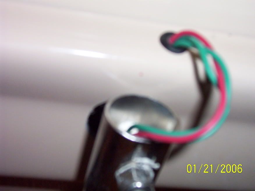

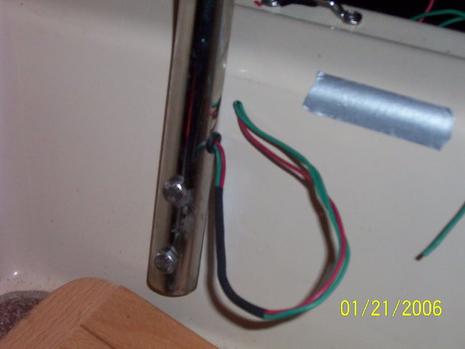

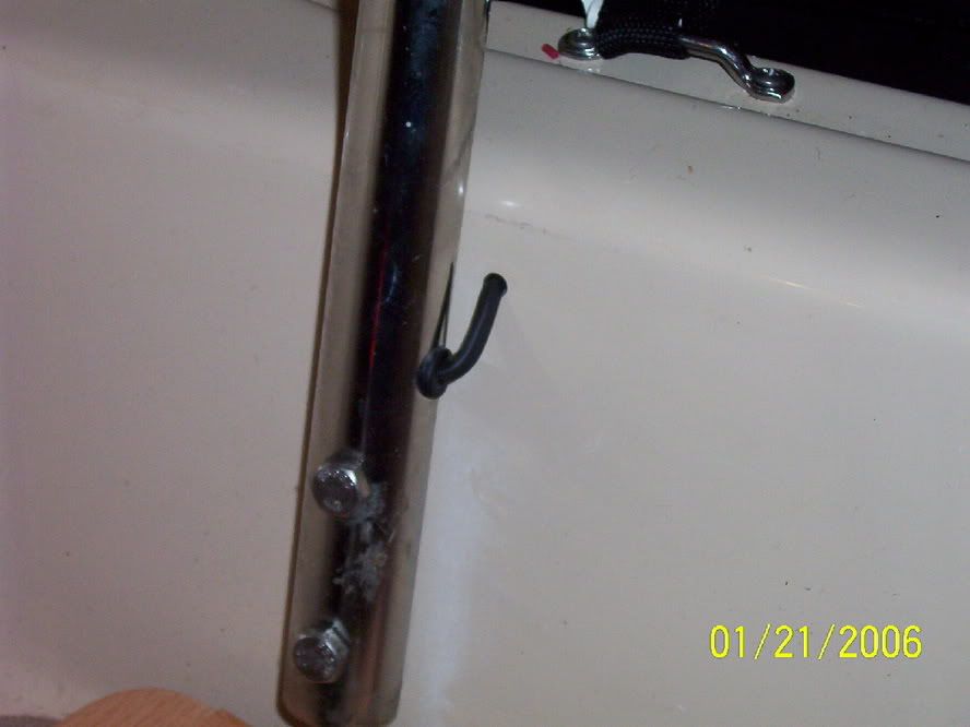

Good afternoon all....I had also hid some wires on our 2004M.I needed to run some from behind the "switch panel" to the other side of the cabin and down to the batteries. May be unorthodox, but I think it came out good.ImageImageImage The first picture is the top{unfinished}, the second is the bottom{unfinished},and the third is the bottom finished. That is the cabin ladder pipe,port side going out. ....Happy Sailing....Don
