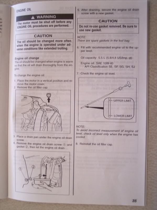

Any one have instructions for maintenance and oil changes on the Suzuki. Seems someone posted them awhile back but cant narrow it down in the search...got 1278 items..

The 90 should be the same as my 140. Is this what you are looking?
Oil & oil filter --- replace @ 20 hrs. and then every 100 hrs. or 6months
Gear oil-----same as oil
Plugs----inspect @ 100 hrs. & replace @ 200 hrs.
Impeller----replace @ 200 hrs
Low pressure fuel filter-----replace @ 400 hrs.
High pressure fuel filter----replace @ 1000 hrs.
Other items anodes, bolts (tighten @ 200 hrs), bonding wires, etc.)---- inspect
Oil/filter change pretty straight forward. Even I can do it. :D
Should be able to get an owner's manual (46 page paperback) from a Suzuki dealer. Any other questions? :)

Post by Idle Time »
I think we had all that....wasnt sure if I could get instructions for the actual oil change...but it its that straigt forward he should beable to figure it out.
Is it something that can be done while on a trip?

Will this help?
[/img]
Idle Time
Posts: 434
Joined: Sat Jan 31, 2004 4:28 am
Post by Idle Time »
Thanks....I think that's what I needed.
