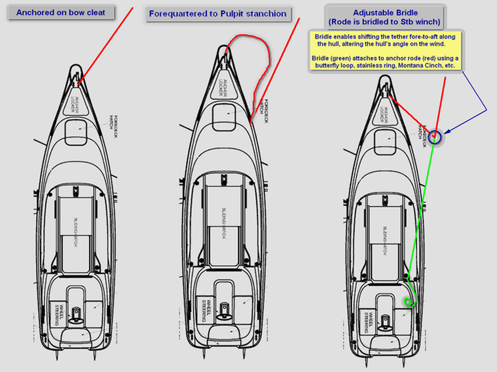

If you haven't yet experienced a Mac swinging at anchor? ... it compares to taking a toddler on the Merry-go-round. I explained my stab at the underlying logic in an earlier thread, as below. But Sloop is correct, a bridle is mandatory if you want to avoid extraneous solutions, like a stern anchor or a drag anchor.
You can quickly test the concept. Anchor at the bow cleat and enjoy the Merry-go-round for a half-hour. Then go to the bow and pull ten feet of slack rode from the locker (behind where you're already cleated). Lead the slack rode outside the pulpit and tie-off securely to the aft pulpit stanchion, then release your original belay at the bow cleat. The boat will now be tethered at the aft pulpit stanchion, the bow will remain on the wind, but the swing will be reduced by two-thirds of its prior arc.
Once you've experienced the difference in anchoring on the forequarter (somewhat aft from the bow) you'll make it SOP. A dockline makes an easy bridle back to a winch or the aft cleat. Rigging a bridle is especially easy with a Montana cinch (Jeff Stagg's hint) on your anchor rode about 7 feet out from the bow cleat. All chain rode? ... then just tie the bridle into a link. To rig a bridle, see below.
1) It's pretty easy to picture how the anchor can "wag the dog" with a perfect fulcrum at a bow tether (first drawing). By contrast, the forequartered hull simply cannot swing as effectively.
2) When tethered aftward enough the hull simply cannot cross the eye of the wind, which eliminates the Mac's habitual anchor-tacking. Use this for testing, but it's clearly not good SOP to anchor to a stanchion.
3) There are many alternate ways to rig a bridle. I was partial to one that went from the port bow cleat, down through the boweye, then back to the Stb winch. It tied to the rode in about the same position, always with rode still slack-cleated to the bow for safety. That bridle permits more flexibility in shifting the tether. But it's very important to be able to quickly weigh anchor. This bridle approach (third drawing) adds zero-delay to making a quick departure.

Edit: Anchoring & Bridling ExamplesFrank C wrote:The Mac's anchor-tacking in an anchorage full of keelboats is actually embarrassing. But snubbing the rode at the forequarter completely eliminates the tacking and allows her to ride just like the keelboats.
Roger's Powersailor hull "sails on anchor" because a bow-attached rode encourages the hull's "tacking" on the anchor rode. The wind creates lift across the Mac's generous freeboard, causing a swing to one side. The swing ends as the wind "sucks" this hull-lift to its stalling point. But now wind pressure on that aft windward hull surface PUSHES the hull toward the lee side. Since our very light weight hull is tethered on a long rope it swings like a pendulum. As it crosses the eye of the wind, the lee bow becomes a lifting surface, amplifying the swing in this new direction -- until it stalls again. Repeat continuously!. The hull likes to sail out to ~65 degrees, so the swing-arc is ~ 130-degrees ... makes me dizzy, especially the view through the companionway from down in the cabin~!
NOW ... attach the rode to a point 20% aft from the bow. The Mac will remain constantly on a single tack versus the prevailing breeze. The hull is now a less efficient pendulum with more aero-drag, and it cannot cross the eye of the wind. Eliminate the anchor-tacking and reduce the anchor-arc to about 35 degrees. The further aft you set the rode's attachment to the hull, the smaller her hunting arc becomes ... to a point. The hull will ride bow-to-wind with the anchor rode holding at about 35 degrees off-wind, keeping wind waves on the bow. Obviously, a bridle permits tweaking the anchored position, like trimming an upwind jib sheet.
An anchor bridle helps to keep the rode's attach point lower to the water, but a bridle is not essential to my solution. You can just tether the hull at either fore-quarter, rather than the bow, by having a line chock at the quarter-rail. Rode led through this line chock will be fore-quartered regardless of location of the cleat, or even use mast itself. You can test the concept by tying your rode at either pulpit aft stanchion.
To rig a bridle, cleat the rode at the bow, then tie a dockline directly onto your rode, about 7 feet down from the bow cleat. Now snub the other end of the dockline-bridle with 3 wraps on the winch, and into the cam-cleat. The bridle simply permits you to "tune the arc" by changing length on the dockline. If you object to tying a loop into your rode (like me), insert a Montana cinch (Jeff Stagg's hint) onto your anchor rode about 7 feet out from the bow cleat.
