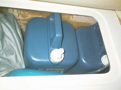

I went with two hard coleman 5 gallon tanks. We find we get 2 - 3 days from one tank with my family of 5 on board. They fit easily up front in an X, an M might be more of a challenge to find a place. I fitted a dip tube to one of their caps and it is simple to switch tanks. I still like being able to remove the tanks for easy filling and cleaning. Even out at anchor we can dinghy in and fill the water at a park.
The plumbing feeds a 'on demand' pump (I've disconnected my head faucet as we never used that sink). I like these a lot better than the true marine pressure pumps. There is no pressure left in the lines to cause leaks over time. The galley sink faucet has a switch in it so when you turn the water on the pump turns on. Clean simple, leak free, no accumulator tanks. The pump and faucet were around $60 (looks like more now).
