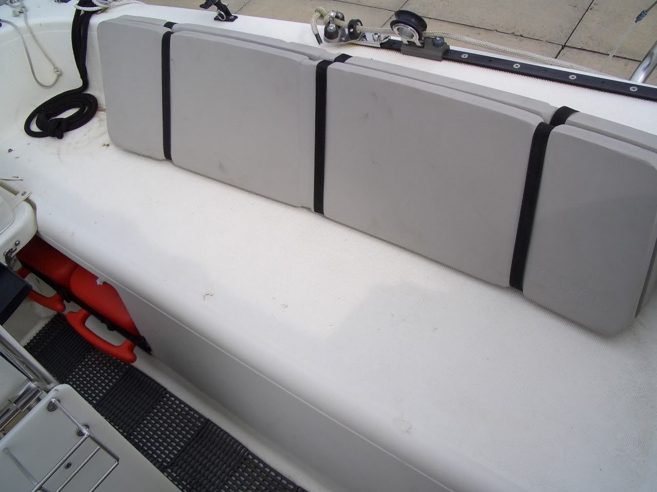

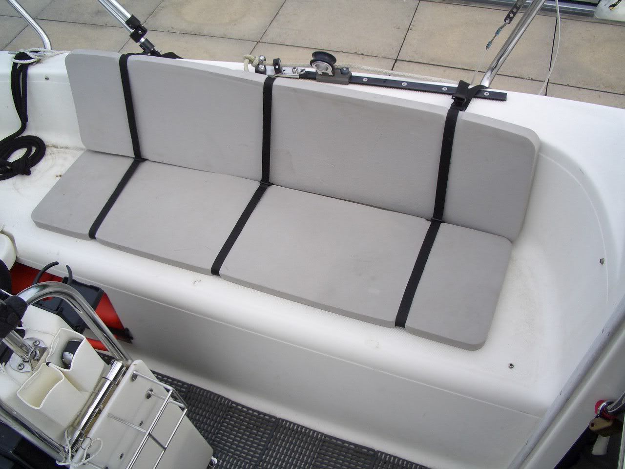

I have a set of the factory cushions and the snaps to hold them on, which look great and are full coverage, but as they are somewhat delicate, and too HOH absorptive, and never dry out after a soaking, and are difficult to store inside when damp, and are so time-consuming to deploy, I have a second set of generic closed-cell foam cushions with no covering needed, that I use with webbing straps to use for utility cushions and for mixed weather.
They fold upwards for keeping cleaner, the straps are fashioned around the cushions in a figure eight pattern that keeps them together, yet apart, if you will, and stay in place with the part of the straps extended around the side-pupit and bimini mounts.
