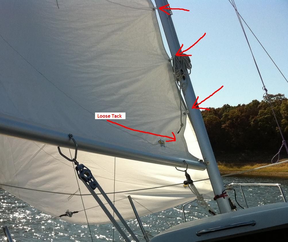

I'm beginning to think that some of you have main sails without slugs. See slugs below. That might explain why your main is so hard to hoist.
The loose tack is from not having the halyard tight enough. Nothing is supposed to be fed into the track below the mast gate. This is not my boat. Mine has a luff rope that tightens this up. Gonna have to drag the sail bag out of the closet to check.
