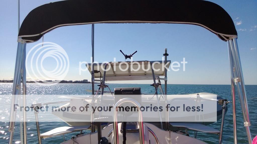

Hi kadet, would you mind posting some pics of your davits

Here is a series of picture for you.
http://s511.beta.photobucket.com/user/_ ... ary/Davits
The wire bracing has now been replaced with an aluminium frame and an 80W solar panel mounted on it.
I also use the V berth locker space for storage of extra sails and dive gear. The bow portion looks like a good spot to put a bladder.
