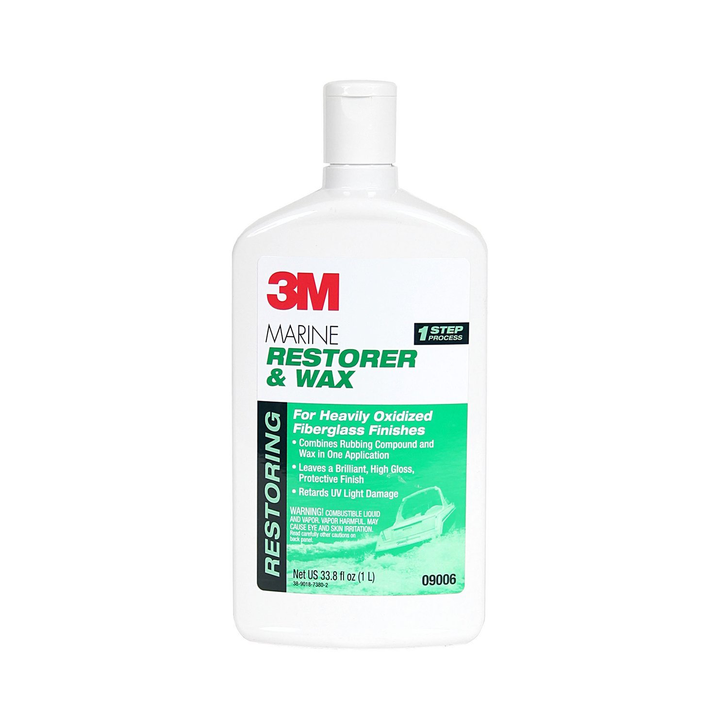

I discovered this miracle stuff. Parts of my blue hull were oxidized and compound didn't do much about it. Then I tried this.
https://www.amazon.com/3M-Marine-Restor ... 1532800384
Invest it a good buffer. I bought this one. Don't cheap out and you will be glad. You need the high RPMs that hand buffing can't achieve as well.
https://www.amazon.com/DEWALT-DWP849-7- ... B004W1WGIC
Then get a quality lambs wool pad.
https://www.amazon.com/Pack-Buffing-Com ... 1532801371
Quality cost. But the results are worth it.
This stuff isn't like wax you've used before. You put it on wet and then buff dry.
AMAZING results. My oxidized blue looked better than new. I swear by this stuff now If am singing its praises from rooftops.
I used it on everything. Windows, topsides. Great stuff. Highly recommended.
It's probably not a good "wax". I put a coat of good marine wax after the polish.

I wish I took before photos.
The black was all oxidized and gray. The blue was faded really bad especially on the transom. Compound alone didn't work.

I would NOT WET SAND. That should be a last resort. Seriously, try the 3m restorer with a buffer. The job will go super fast and you'll wonder why you struggled with hand compounding.
